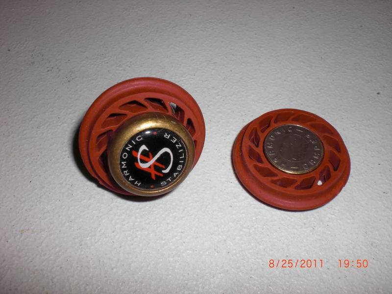

basically, I am trying to reduce vibrations from my break barrel air rifle which has dual recoils in either direction. they happen almost simultaneously, but it still throws off my accuracy as one occurs just before the pellet leaves the barrel. the kick isn't strong but rather sharp. here's a pic so you may get a better idea:

and then i came across this:
Two red rubber harmonic stabilizer dampers with ventilated cutout rims; the left one has a gold-colored metal cap printed with HARMONIC STABILIZER and a red and black logo.
The Mathews Harmonic Stabilizer dampens residual bow vibration by 75 percent and significantly improves bow balance and aiming.
what if i were to mount these onto the stock of my rifle? the gun is about twice as heavy as a bow, but it should still make a difference, right? what concerns me is that the bow is uniformly made of aluminum alloy, whereas for the gun, the initial vibrating part is the metal internals, which are held tightly to the wooden stock by screws. would i gain noticeable benfits from this?
I looked at the Mathews website but it doesn't seem to have much real description of how these dampers work. But assuming they do work for bows, the design will probably be accurately "tuned" to match the dynamics of the bow. Whether that was done by a lot of trial and error, computer modelling of the dynamics, or they just got lucky, doesn't really matter.
If you put the same damper on a something with different mass and stiffness, and a different pattens of load against time causing the recoil, most likely it won't do anything useful.
