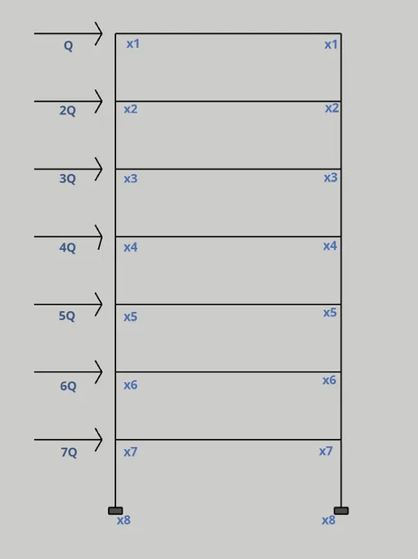

Hi all,
I have a structural engineering book from 1979. I am trying to follow it as best as I can. I have come to a formula that calculates the rotations in radians at the rigid joint that requires an iterative procedure. This equation comes in the form of:
$$ x_i = \frac {Q_ih_i + Q_{i+1}h_{i+1}}{4K} + \frac {C}{K}x_{i-1} + \frac {C}{K}x_{i+1} $$
Where:
## Q ## is the horizontal storey shear
## h ## is the storey height
## K = (6G_i + C_i + C_{i+1}) ##
## G = \frac {I_g}{h} ##
## C = \frac {I_c}{L} ##
## L ## is the girder length
## x ## is the rotations for the ## ith ## storey
The book says to use initial values x by using this formula:
$$ x_i = \frac {Q_ih_i + Q_{i+1}h_{i+1}}{24G_i} $$
After you can compute the rotations for each level use the iterative formula to improve the values of the rotations.
Now, I have used MATALB to do this. Here is my code:

So from this is get my rotations at each storey. I haven't posted my results. I merely hope for someone to check the above workings and let me know if I have done this correctly.
For a visual aid, here is a typical structure of seven storeys with 8 rotations. Note, x8 equals zero because it is clamped against rotation because I am using a fixed support.
I am hoping someone can help?
Many thanks
Looking at your code, I think your Q and h variables need to have indexed values...Q(1) h(1), Q(i+1), etc. Otherwise, it looks ok.
It seems that you have loaded it backwards in the code or the image. As you have written it, a +1 height in your code has it going a higher floor instead of lower floor like you have in the image.
