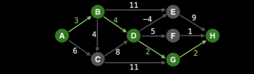

This is the weighted, directed acyclic graph I created in JavaScript

I will attach an image to visualize this graph
Directed acyclic graph with nodes A through H, edges labelled with weights: A to B 3, A to C 6, B to C 4, B to D 4, B to E 11, C to D 8, C to G 11, D to E -4, D to F 5, D to G 2, E to H 9, F to H 1, G to H 2; green edges mark A-B-D-G-H path.

I tested the code for the shortest path from node A to all other nodes, I am getting it right.
The output is { A: 0, B: 3, C: 6, D: 7, G: 9, F: 12, E: 3, H: 11 }

I am getting this wrong, even though the only change is the multiplication of the edge weights with -1.
Output is { A: -0, B: 3, C: 6, D: 7, G: 17, F: 12, E: 14, H: 19 } although for some nodes the output is right.

This bug might be hard to track down. I suggest you focus on what each line of code is doing when it decides that the longest path from A to C is 6 instead of 7 as this is the simplest "error".
Is the idea of multiplying the edge weights by -1 to find the longest path right ? Does it actually work ?
In the graph class definition, this method was returning wrong edges.
Glad you tracked it down, well done.
