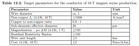

This is an interesting question and I'd love to see someone knowledgeable chime in here. I wasn't able to find out, but I did find this table of target parameters they have for the Nb3Sn type II superconducting wire for HE-LHC.mfb said:How much wire would HTS-ITER need vs. FCC or HE-LHC?
It's mentioned in this paper from about 2 years ago that "the initiative is also a first step in the direction of preparing the ground for a credible large-scale supply chain at global scale."
(2019). HE-LHC: The High-Energy Large Hadron Collider. The European Physical Journal Special Topics. 228. 1109-1382. 10.1140/epjst/e2019-900088-6.
