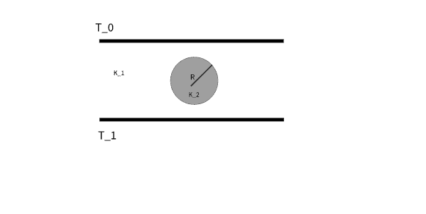

Consider a sphere of thermal diffusivity ##\kappa_2## is submerged in an incompressible and stationary fluid of thermal diffusivity ##\kappa_1##.
The fluid is held between 2 large plates ( at T_0 for the top plate and T_1 for the bottom plate).
What is the stationary temperature distribution inside the sphere and in the fluid ?

Is the temperature distribution axisymmetric (a function of r only)? Please provide a diagram of the situation. From your description, I am unable to visualize the system.
You need one solution inside the sphere and a separate solution outside the sphere. Since [itex]T[/itex] is specified on each of the plates, you must start by finding the outer solution. Having done so, the inner solution is found from the requirement that [itex]\kappa\frac{\partial T}{\partial r}[/itex] must be continuous on the surface of the sphere.

I made a diagram, it might help.
Diagram of a horizontal channel bounded by two thick lines labelled T_0 (top) and T_1 (bottom), with a grey circle of radius R at the centre marked K_2 and the surrounding region marked K_1.
Yes, you need to find the outer solution first. Setting [itex]T_1 = T_0 + \Delta T[/itex], we should have as [itex]r \to \infty[/itex] that [itex]T[/itex] tends to [itex]T_0 + \frac{\Delta T}2 - \frac{\Delta T}{2h} r \cos \theta[/itex]; for that reason I would write [itex]T = T_0 + \frac{\Delta T}2 - \frac{\Delta T}{2h} r \cos \theta + u[/itex] where [itex]u = 0[/itex] on [itex]r \cos \theta = \pm h[/itex]. We can then seek a solution for [itex]u[/itex] which is even in [itex]\cos \theta[/itex], so that [tex] u(r, \theta) = \begin{cases} \sum_{n=0}^\infty A_n r^{2n} P_{2n}(\cos \theta) & r < R \\<br /> \sum_{n=0}^\infty B_n r^{-2n-1} P_{2n}(\cos \theta) & r > R \end{cases}[/tex] where the condition or [itex]r = h\sec \theta[/itex] is [tex] \sum_{n=0}^\infty \frac{B_{n}}{h^{2n+1}} (\cos^{2n+1} \theta)P_{2n}(\cos \theta) = 0.[/tex] ([itex]B_n \equiv 0[/itex] is a solution.) I do not think that you can require continuity of both [itex]T[/itex] and [itex]\kappa \partial T/\partial r[/itex] on the sphere: you have a second-order operator, and you are already imposing the condition that [itex]T[/itex] is finite at the origin.
If I insist that both ##T## and ##\frac{\partial T}{\partial R}## are continuous at ##r=R## then I get contradicting statements.

There is a discontinuity condition for the derivative. The continuity statement is for the current, which is the derivative multiplied by ##\kappa_i##. Since the ##\kappa_i## are different, you obtain a discontinuity in the derivative.

The thermal diffusivities are not the correct parameters to use in this steady state problem. Thermal diffusivities only come into play in transient problems. You should be using thermal conductivities in your analysis.
I would approach this problem differently. To a first approximation, the temperature in both regions should approach a linear gradient in z. So the temperature can be written as the linear temperature profile plus a perturbation. In the perturbation problem, the boundary conditions would be zero at the two boundaries, and a specified normal heat flux at the surface of the sphere (the latter being determined from the first approximation linear temperature profile in the two regions).
