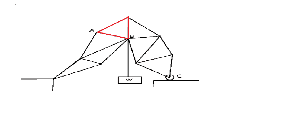

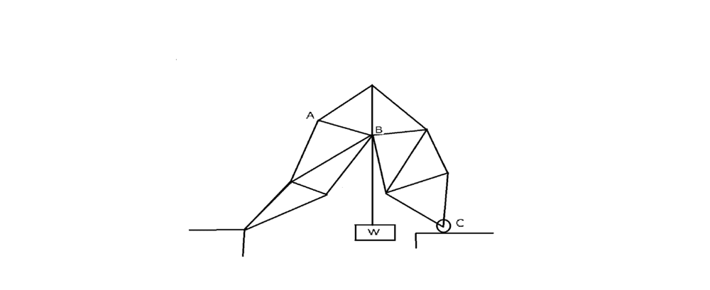

The truss is made of light aluminium struts pivoted at each end.At C is a roller which rolls on a smooth plste.Whe a workman heats up member AB with a welding torch it is observed to increase in length by an amount x and the load is thereby moved vertically an amount y
A)Is the motion of W upward or downward
B)What is the force F in the member AB (Including the sense i.e.,tension or compression)
no equation
A)W goes downward because before AB gets heat up the system was in equilibrium hen after getting heat up the Force that AB produce makes the roller moves to the right and that makes the whole system go down
B)I don't know what it means I know that this can mean the forces that the member Ab is apllying or the forces that are being appliend in member AB(I thnik is the second option)

There may be a way to answer A with a simple argument, as you have tried, but I don't find the argument you offer at all convincing. And B will definitely take some equations, so might as well do A that way too.
First step is to identify the parts of the structure which are effectively rigid bodies as AB changes length. This will allow you to represent it with a simpler structure.

Listen to @haruspex! Do this. If the lengths of the sides of a triangle do not change neither can their angles. Which triangles change? Which ones stay the same? Color the rigid ones in and see if this doesn’t become more obvious.

Since the problem shows no numbers or dimensions, the answer to question B can't be a number.
The force within member AB is only one, that aluminum strut can only be tensioned or compressed (pivoted at each end, as stated).
If rather than inducing thermal dilatation with a torch, the workman of our problem would decide cutting off member AB with a hacksaw, would nodes A and B get closer or farther from each other as the structure fails?
What that relative movement would tell you about the type of load or force that the member is "feeling"?

the one colored is the only triangle that change
Member AB is a common side to two triangles, therefore, at least two must change angles.
new90 said:
the one colored is the only triangle that changeView attachment 260843
Not quite. If you change the length of AB isn’t it one of the sides of TWO triangles?
so 4 angles are cheanged

Call those triangles ABX, ABY. If AB gets longer what happens to the distance XY?

AY is not changing length. BY is not changing length. Neither are AX or BX. Are you sure than when you separate A and B the distance between X and Y will increase? Suppose you have this contraption made of rigid bars AX, BX, AY, and BY with hinges at all the vertices. AB is a bungee. Imagine going to the extreme. What if you pulled A and B very far apart. What happens to X an Y?

Model it with your hands. Put your thumb tips together as point X, your fingertips together as point Y, and the joints at the bases of your thumbs as A and B. As you move A and B together and apart, what happens to XY?

In the hand model, AB is the distance between the joints at the bases of your thumbs, and XY is the distance between your fingertips and your thumbtips.
As you increase the distance between your thumb bases, the distance from your fingertips to your thumbtips decreases, right?
yes that's what i was trying to say
