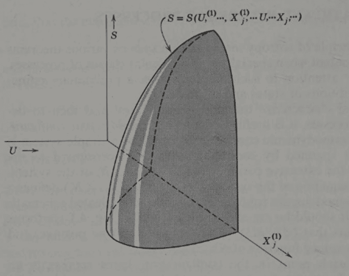

For the diathermal piston problem, most of the points of the entropy surface in configuration space (Callen Fig 4.2 shown below) represent “constrained states” where the piston would have to be adiabatic to keep the system in that state.
Graph of a surface S = S(U, X_j) plotted against axes U, S and X_j^(1), with a dashed curve on the surface and dashed lines on the base, labelled with the entropy function.
If the piston is fixed in place and impermeable to the substances in the subsystems, then a constrained state would be characterized by the energies of the subsystems. To change the system from one constrained state to another, we would need to interact with the system to adjust the energies of the subsystems. Once set up, the system will remain in the constrained state forever if the system is isolated and the piston remains adiabatic. While in this state, we can imagine that the piston somehow becomes diathermal. The subsystems will now exchange energy and the composite system will move to some “unconstrained” equilibrium state ##A##. The entropy maximum and energy minimum principles describe properties of the unconstrained state ##A##.

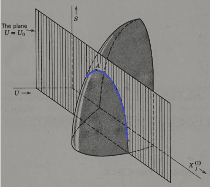

If I’m understanding these principles, then I think they could be worded in the following way.
Entropy Maximum Principle. Let ##\Omega_{U_A}## be the set of states of the composite system that includes the unconstrained equilibrium state ##A## as well as all the constrained states that have the same energy, ##U_A##, as state ##A##. This is the set of states colored blue in the diagram below. Then within this set, ##A## is the state that has the maximum entropy.
3D graph of entropy S against energy U and a configuration coordinate X, showing a curved entropy surface with a blue curve on the plane U = U0 and a labelled point A at its peak.
Energy Minimum Principle. Let ##\Omega_{S_A}## be the set of states of the composite system that includes the unconstrained equilibrium state ##A## as well as all the constrained states that have the same entropy, ##S_A##, as state ##A##. This is the set of states colored green in the diagram below. Then, within this set, state ##A## has the minimum energy.
3D graph of entropy S against energy U of subsystem 1, with a curved entropy surface, a horizontal hatched plane S = S0, and a green curve on the surface labelled A at a point on the plane.
The isolated, composite system could never move on its own from one of the constrained states in ##\Omega_{S_A}## to a neighboring constrained state in ##\Omega_{S_A}##. That would violate conservation of energy for the isolated system. But there's nothing in the statement of the energy minimum principle that requires the system to be able to move on its own between these two states.

If state ##A## is an equilibrium state for the diathermal piston, then ##A## will satisfy both principles.
I think this is starting to get me towards understanding. You are saying that, given an isolated system, the (final) equilibrium system is that for which
1) At its value of the energy, ##U_0##, it has the maximum entropy or, equivalently
2) At its value of the entropy ##S_0##, it has the minimum energy.
I suppose I can accept this as being logically consistent, at least a priori.

What you say above is correct. Searching the ##U = U_i## plane for maximum entropy will yield an equilibrium state that is actually the equilibrium state that the system would evolve into from the initial state. But, as you say, searching the ##S = S_i## plane for minimum energy will yield a state that is not the equilibrium state that the isolated system would evolve into from the initial state.
The two principles are concerned with entropy and energy planes that contain the final equilibrium state ##A##, not the planes containing the initial state ##i##. Of course, since the system is isolated, the energy plane containing the initial state will also be the energy plane for the final state.
The two principles state that ##A## is the state of maximum entropy in the ##U_A## plane and state ##A## is also the state of minimum energy in the ##S_A## plane. The principles give you equivalent conditions that must be satisfied in order for ##A## to be the equilibrium state.
Both principles allow you to find, in principle, the final equilibrium state for a given initial state, ##i##. For example, in the diathermal piston problem with monatomic ideal gases as the subsystems, Callen shows how both principles lead to the condition that the two subsystems must have the same temperature ##T_A## in the final state. If the system was isolated while evolving from ##i## to ##A##, then we know ##U_A = U_i##. (Neither principle is needed to know this.) Thus, the value of the final equilibrium temperature can be calculated from $$U_A^{(1)} + U_A^{(2)} = U_A = U_i$$ or $$\frac 3 2 N^{(1)} RT_A + \frac 3 2 N^{(2)} RT_A = U_i$$ from which we can solve for ##T_A##.
