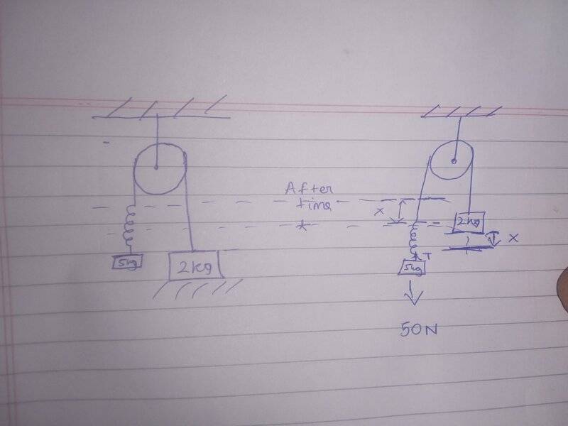

The system as shown in the figure is released from rest. The pulley, spring and string are ideal and friction is absent everywhere. If the speed of 5 kg block when 2kg block leaves the contact with ground is 2(x)^0.5 m/s then value of x is: (spring constant k= 40N/m & g=10m/s)
None
I guess im still a bit rusty with spring problems. Heres the given figure:
Can someone walk me through what exactly would happen when the system is released from rest. Mainly im concerned about the 5kg block when it moves down by say a distance x, this means the gravitational force is more than the tension in the string above, but due to this tension the spring will elongate, but the upper part of the spring is not connected to a fixed support so it will accelerate downwards as well, making the elongation 0 hence the spring force 0? So what is the tension in the string connecting the 2kg block and the spring...
I have a lot of assumptions which seem very hand wavy and lead to nothing but more confusion....

Draw a new diagram when the 5kg mass has dropped a small distance.

I am unsure about the forces as I peeked at a solution and saw that the tension is apparently the spring force
tellmesomething said:
I peeked at a solution and saw that the tension is apparently the spring forceView attachment 342443
The (idealized) spring has zero mass. Apply Newtons 2nd to it as a free body to see why that is the case.
The 5 kg moving a distance x is not equivalent to the 2 kg mass moving a distance x off the ground. Until the spring has elongated sufficiently to give enough tension to lift the 2 kg mass off the ground, the 2 kg mass won't move.

Thats what I dont get. The spring force is acting on the block in the upward direction....Yes?
The spring is pulling the support with the magnitude of force it itself is being pulled by I.e 50N no?

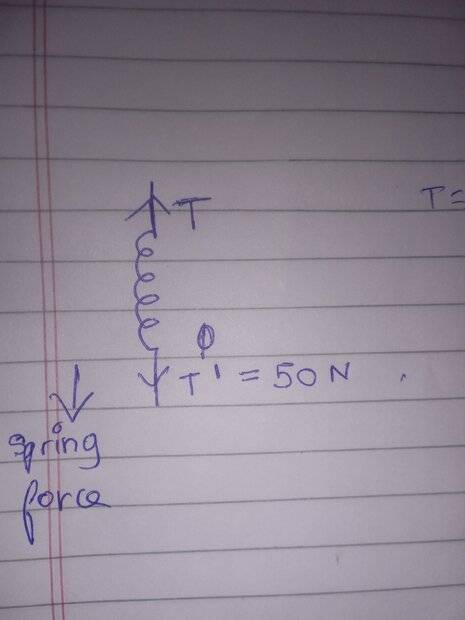

Missed this, I made a FBD of the spring not sure how this is supposed to tell me that its massless...to be fair SPRING FORCE reaction pair is more fitting..
Missed this, I made a FBD of the spring not sure how this is supposed to tell me that its massless...to be fair SPRING FORCE reaction pair is more fitting..View attachment 342447
This is incorrect. Again, the 5 kg weight is not pulling the spring with 50 N. If it were, it could not accelerate!
edit: The forces on the spring are also not a reaction pair!

I understand your part now the mass wouldn't have been able to accelerate if the net force becomes zero makes sense.. T' = 50-5a..
a being the acceleration of the block?
If the spring had its own mass, whose mass center would be accelerating, there would have to be a net force on the spring. As it stands this spring is ideal, massless( otherwise we would have some more information). Because it has no mass the force balance ( even as it accelerates with the falling mass) is zero. This is not to say as @Orodruin points out that ##T## is 50 N though.

When the spring elongates there's a restoring force acting on the mass of 5kg trying to pull it back to its original position....im talking about the reaction pair of this force which would be exerted by the block on the spring

Considering what you both said...
T'= 50-5a (a being the acceleration of the block)
T= spring force + 50-5a
If this is correct in the slightest...how do I find the acceleration of the block
No.
If the spring is massless then the net force on it is zero. (Do you see why?)
According to your diagram in post #20, what is the net force on it?
haruspex said:
Yes
No.
Do you mean we will not include the tension by the string in the FBD of the spring..... IF so why? I get that the net force on the string is 0 but the tension should still be pulling on the spring...
