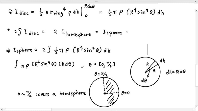

DeadInside

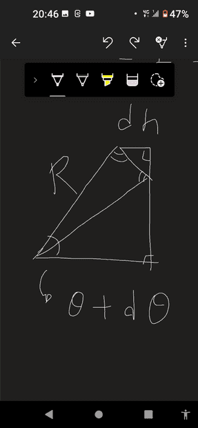

Axis is through center of mass of the solid sphere.

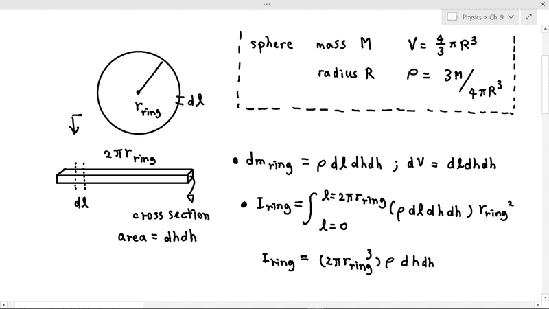

I first integrated dm to find MOI of a ring.

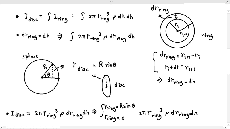

Then I used MOI of a ring to find MOI of a disc.
Then I used MOI of a disc to find MOI of solid sphere
I know I must have done something wrong somewhere here, but I cannot figure out exactly which one
Answer is supposed to be (2/5)MR2
Whatever disaster I have in the last image does not evaluate closely to that at all.
I'm not looking for another way to find the MOI of solid sphere, I would just like to know what I am doing wrong here. Any input is welcome. Please and thank you.
##dh## should be the thickness of the disc. Draw a figure showing the disc inside the sphere for some angle ##\theta##.
Hi, thanks for the suggestion. I tried drawing the diagram, but I still don't understand. dh is the thickness already?? I'm really confused.

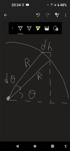

Your diagram (3rd image in post #1) shows dh as a distance around the circumference of the sphere. Your expression ##dh=Rd\theta## conforms to that. But that is not the thickness of the disc, which is what you need dh to be according to your integral.

At first, I couldn't understand, but what you said clicked later on.
I followed this and revisited the relationship between ##dh## and ##d\theta##. But I still was unsure what I had to change.

Although this isn't exactly what I looked for, but it hinted me that I may have ignored that:
1) as TSny said, ##dh## should ONLY be the thickness of the disk and ring. It shouldn't be readily assumed as arc length of a small circular segment. Numerically they might be close, but by principle they are not the same.
2) as haruspex further said, because I assumed ##dh=Rd\theta##, it restricts ##dh## to a small arc length, which obviously isn't true when it was first established as thickness of disk and ring.
This all clicked when I saw the solution you offered. I thought there must be a trigonometric relationship between arc length and thickness ##dh##.
I don't have access to PC for a while so I will add the solution a few days later.

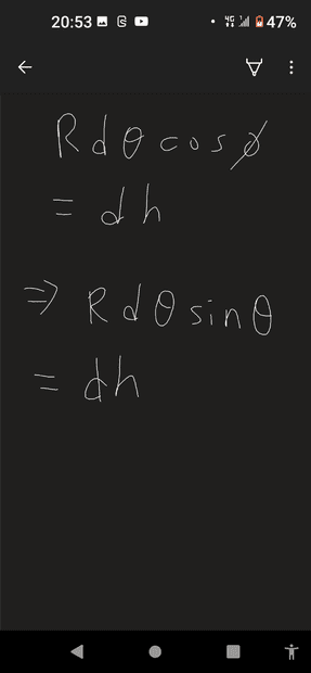

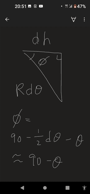

This is the temporary brief explanation I drew on my phone:
The angle here can be found simply with some subtraction and addition of some polygon angles.
This is the actual relation between ##dh## and ##Rd\theta##.
Thank you all brilliant and kind minds so so much for your inputs. I have finally ended my 3 days of agony.
