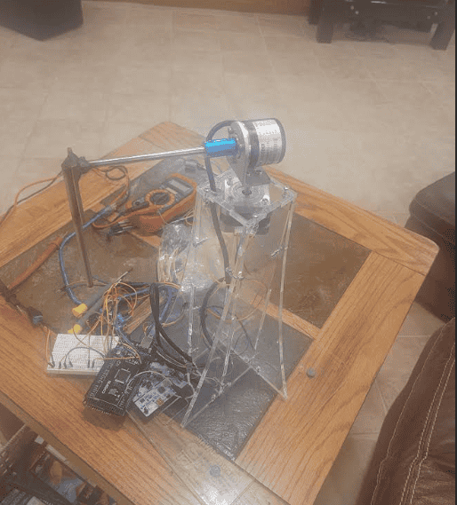

Compute the moment of inertia seen by the motor shaft for a rotary inverted pendulum
I_{\mathrm{total}}=I_m+\frac{1}{3}m_al_a^2+\frac{1}{3}m_pl_p^2+m_p\left(l_a+\frac{l_p}{2}\cos{\left(\theta_{i-1}\right)}\right)^2
I looked all over the internet and I can't find a derivation of this. It is over my head to derive this.
This is my system:
I want to assume that the pendulum and motor arm are uniform rods. I want to ignore the motor shaft inertia and the rotary encoder inertia since they are negligible. Does anyone have the formula for J about the motor shaft? I imagine this is dependent on the angle of the pendulum.

You need to post a labeled diagram of your system. How can we possibly assist if we don't know the meanings of the symbols ##I_m,m_a,l_a,m_p,l_p,\theta_{i-1}##?

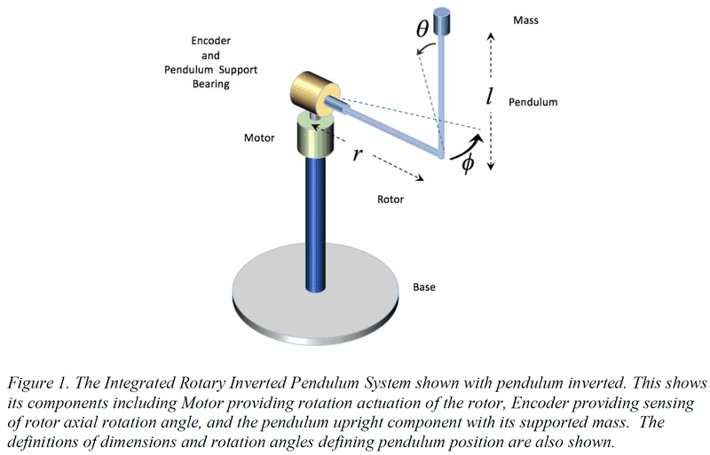

And from the photo of your apparatus in post #1 I surmise that the following is a reasonable representation of your inverted pendulum (but without the Mass at the end of the pendulum rod):
(From: https://www.st.com/content/dam/AME/...to_Integrated_Rotary_Inverted_Pendulum_v2.pdf)
If my surmise is correct, can you attempt to write down the formula for the moment-of-inertia ##I_{\text{total}}## seen by the Motor-shaft, in terms of the variables ##r,l,\theta,\phi## shown in Fig. 1 and the masses of the Rotor and Pendulum rods?
renormalize said:
OK, thanks to @haruspex I've found your previous post that defines most of the variables in your Relevant Equation:
(From: https://www.st.com/content/dam/AME/2019/Educational Curriculums/motor-control/Introduction_to_Integrated_Rotary_Inverted_Pendulum_v2.pdf)
