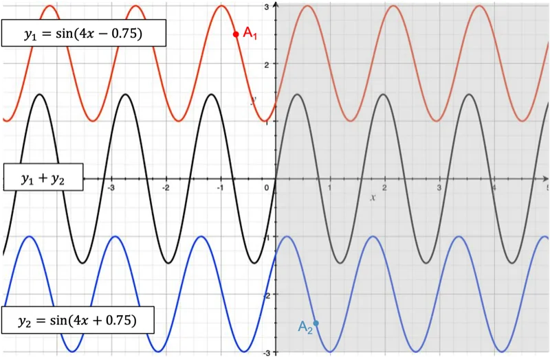

im having a hard time figuring out how reflection of a wave from fixed end with 0 transmission and 0 energy loss changes the equation of a wave.
i've been told the reflection of the wave y=A sin(wt-Kx) is y=-Asin(wt+Kx) which is obtained by:
- changing the sign of -Kx to +Kx to indicate change in direction (A sin(wt+Kx))
- then multiplying with -1 to indicate inversion of the wave
but when i follow these steps for the wave y=2 sin(4x-8t)
i get 2 sin(4x+8t) when the answer key says it should be -2 sin(4x+8t). Where am i going wrong?
y=A sin(wt-Kx)
y=2 sin(4x-8t)
y=2 sin(4x-8t)
y=2 sin(-4x-8t) (opposite direction)
y= 2 sin(4x+8t) (opposite direction and inverted)

You did not verify that what you wrote down is what you want. What you wrote as "opposite direction"
is the answer. That's because the sine is an odd function meaning that sin(-u) = -sin(u)
So sin(-4x - 8t) = -sin(4x + 8t) which is what you want.
The convention for x is that it increases to the right and decreases to the left. Time t always increases and frequency w is always positive. If you write y = sin(kx - wt), you see that the wave travels to the right because since time always increases, to keep the phase (kx - wt) constant x must increase. Likewise, If you write y = sin(kx + wt), you see that the wave travels to the left because since time always increases, to keep the phase (kx + wt) constant x must decrease. The same would be true if you wrote the wave as a cosine.
The bottom line is to always write the wave as y = sin(kx ± wt) with the understanding that the top sign is for a wave traveling to the left and the bottom sign for a wave traveling to the right. To flip direction, you flip the sign in front of w. It's a good idea to bring the wave in this standard form before you do any flipping.
For example, if this problem gave you y = sin(-kx - wt) as the initial wave, you would write
y = sin(-kx - wt) = -sin(kx + wt) is the given wave in standard form
y = -sin(kx - wt) is the given wave traveling in the opposite direction
y = +sin(kx - wt) is the inverted given wave traveling in the opposite direction

I assume the fixed end is at x=0. That means that the sum of the waves should be always zero there.
Official answer :
2 sin(4x-8t) -2 sin(4x+8t) = -2 sin(8t) -2 sin(8t) = -4 sin(8t)
Your answer:
2 sin(4x-8t) +2 sin(4x+8t) = -2 sin(8t) +2 sin(8t) = 0.
You win.

But if ##y = 2 \sin(4x-8t)## is a wave on a string traveling to the right and it reflects off a barrier fixed at ##y=0## then the reflected wave must be ##y = -2 \sin(4x+8t)##.

It seems to me that you're saying that ##y = 2 \sin(4x-8t)## is a wave on a string traveling to the right and it reflects off a barrier fixed at ##y=0## then the reflected wave is not ##y = -2 \sin(4x+8t)##.
Firstly, I don't see how a wave travelling to the right could reflect off a point where ##x=0##.
Secondly, perhaps the refection is not at a point where ##y=0##?
Perhaps there's an error in the OP. That's why I'd like to see a statement of the problem that's being solved.
No, you seem to have x and y confused. x is a position along the string and y is its local displacement at position x and time t.
The barrier is at x=0 (we have to assume) and its nature is a fixed point, i.e. y=0 there for all t. So if we substitute x=0 in the equations then the total wave must be zero for all t.
That is not true if the reflected wave is ##y = -2 \sin(4x+8t)## since both waves reduce to ##y = -2 \sin(8t)##, but it is true for ##y = +2 \sin(4x+8t)##. So ##y = -2 \sin(4x+8t)## cannot be a solution, whereas ##y = +2 \sin(4x+8t)## could be.

The two waves travelling in opposite directions, described by ##y=A \sin (kx-\omega t)## and ##y=A \sin (kx+\omega t)##, will produce a standing wave. One would not write ##y=-A \sin (kx+\omega t)## for the equation of the reflected wave.
If a pulse of height ##y=2## reflects off a fixed end, the returning pulse does indeed have a height ##y=-2##. But to see that one has to wait for a time ##t## equal to one quarter of the wave's period. Again, it doesn't imply that one would write ##y=-A \sin (kx+\omega t)## for the equation of the reflected way.
My mistake.

I will try to summarize what has been said with a plot that, I hope, clarifies fuzzy concepts. We have established that the equation $$y(x,t)=A\sin(kx-\omega t)+A\sin(kx+\omega t)$$ (a) consists of two traveling waves, one to the right and one to the left and (b) it may describe a reflection at ##x=0## where ##y(0,t)## vanishes for all ##t##.
What has not been clarified is the context of "reflection". In order to have a reflection, there must be an incident wave and a reflected wave. Which is which depends on one's choice. So let us choose the incident wave coming from the left in the "allowed" region ##x<0##. It bounces off at ##x=0## and returns where it came from. The region ##x>0## is "forbidden". The figure below shows a snapshot of (a) a traveling wave to the right (red), (b) a traveling wave to the left (blue) and (c) their sum (black) which is a standing wave. These waves are drawn extended into the shaded forbidden region to assist the reader's visualization. We may imagine them as invisible "ghosts."
We now consider an arbitrary constant-phase point ##\text{A}_1## on the incident red wave at ##x=-x_0## and at ##t=t_0.## The displacement is ##y(\text{A}_1)=\sin\left[k(-x_0)-\omega t_0\right]=-\sin(kx_0+\omega t_0).## This constant-phase point travels to the right with velocity ##v=\omega/k##. Similarly, there is a conjugate constant-phase point ##\text{A}_2## on the blue wave in the forbidden region at ##x=+x_0## traveling to the left with the same velocity ##v##. The displacement is ##y(\text{A}_2)=\sin(kx_0+\omega t_0).## Clearly, ##y(\text{A}_1)+y(\text{A}_2)=0## for all conjugate pairs ##\text{A}_1## and ##\text{A}_2## at all times.
We can now imagine point ##\text{A}_1## approaching ##x=0## at constant speed. Its inverted ghost reflection ##\text{A}_2## is also approaching ##x=0## from the opposite direction in the forbidden region. The two reach ##x=0## simultaneously at which time incident constant-phase ##\text{A}_1## enters the forbidden region as a ghost whilst ##\text{A}_2## begins its real existence as a reflected and inverted (relative to ##\text{A}_1##) constant-phase traveling to the left with the blue wave.
It is worth noting that if an arbitrary waveform is assembled as a linear combination of sinusoidals, then it will also undergo inversion upon reflection as each of its components does so individually.

Added shading to the forbidden region to a wave incident from the left. For incidence from the right, one needs just to swap "forbidden" and allowed.
