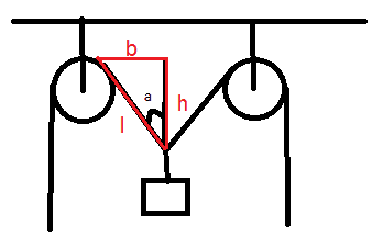

Block rising between two downward-moving wires at angle α

if the 2 wires on both sides move with downward velocity u , with what velocity does the block rise , the angle with vertical is a ;
i cannot figure out the solution, i think it should be 2ucos(a)
please help!1
consider the triangle in red
use Pythagoras theorem on it and differentiate it.
dh/dt is what you need and dl/dt is speed of string
what you think of db/dt ?

thanks cupid.callin !
so is 2ucos(a) right? i think it should be!
no its not ...
even i thought it should be but its not
try the way i told and you'll get the answer
