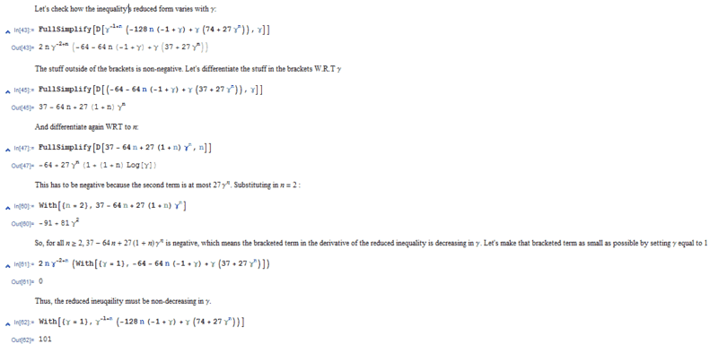

So far, I have managed to reduce this problem to one of showing that
[tex]\gamma ^{n-1} \left(128 n (1-\gamma )+\gamma \left(74+27 \gamma ^n\right)\right)\leq101[/tex]
for
[tex]\gamma\in(0,1)[/tex]
and
[tex]n\geq2[/tex]
(for details see below).

[tex]\gamma ^{n-1} \left(128 n (1-\gamma )+\gamma \left(74+27 \gamma ^n\right)\right)\leq101[/tex],
but I still don't know how to show that this holds over the relative range of parameter values.

I think I managed to finish off the proof. The remaining steps are shown in the attached image for anyone who is interested, or encounters a similar problem.
