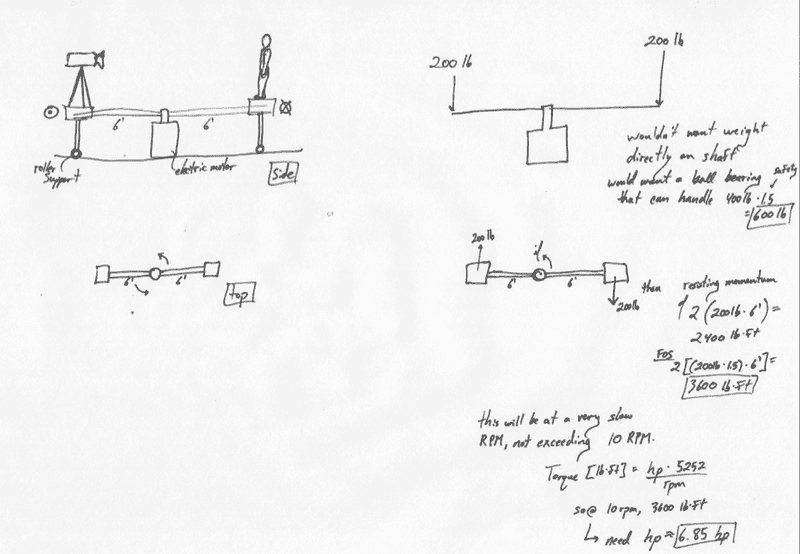

Dear PF,
This is my first post, so please pardon any faux pas.
I've had some difficulty wrapping my head around the concept of torque. I have taken multiple classes on dynamics, statics, etc. I understand it theoretically, but not practically.
A friend presented me with this problem (non-commercial) that requires an application of torque. He's moved on from the project, but I'd still like to understand it. Any help is very much appreciated, thank you!
// Problem
What motor is needed to turn a camera dolly supporting both a man and a camera, as shown in the attached picture? I've attached a drawing, along with the work I've down on the problem.
Here is a link to a selection of electric motors, rated by horsepower, rpm, and AC/DC. How do I make a selection? How do I know a motor will provide enough torque to start them spinning and get them to at least 10 rpm?
If any more information is required, please let me know. Thank you in advance.
http://www.mcmaster.com/#electric-motors/=t4fns3

I see you've calculated moment of inertia
How much torque will you need in order to accelerate your inertia to your 10 RPM in whatever time you want it to accelerate?
I see you did a T=I[itex]\alpha[/itex]
but i think you need to work in radians
http://hyperphysics.phy-astr.gsu.edu/hbase/n2r.html
And are there rolling supports under your man and camera? If so, take a fish scale and see how much force you need to drag them along . That times six feet is the torque you'll need to keep 'em turning once they've been accelerated.

I think everything I posted above is right, but I've been lead to another question while returning to the original problem.
The loads (man and camera) are perpendicular to the rotation of the motor. Will these loads only translate into in-plane friction that the motor has to overcome and contribute to the system's moment of inertia? Is that all there is to it?
Also, I'm having trouble calculating the friction the motor has to overcome.
0. Know: load=1800N
assume: friction coefficient ~ .2
But that would only conclude to a friction in N, not N*m. Is there a different way to calculate rotary friction?

For the friction, all you have to do is multiply the friction force with the distance between the friction force and the center of rotation.
--> Rolling Bearing Friction
And, yes, for the camera, the load has to be supported somewhere, which will translate into a friction force in the plane of rotation. From your drawing, it would be at the rolling support under the camera.
A-ha! That makes sense. Thank you.
However, I see that since the rollers are directly below the loads (person, camera) it makes sense that would mark the distance from the axis of rotation for calculating rotational friction.
However, what if the rollers were not right below them? What if they were halfway towards the axis of rotation? Would the distance be to the rollers, or to the load for calculating rotational friction?
A force applied at a right angle to a lever multiplied by its distance from the lever's fulcrum (the length of the lever arm) is its torque.
In your case the force that creates the torque is the friction force (and its is perfectly perpendicular to the lever arm), so it is the distance from that force to the center of rotation that counts as the lever arm's length.
