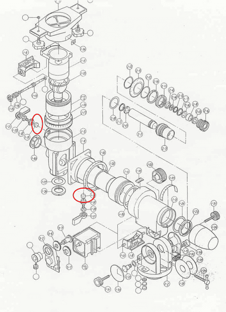

My eq mount was not behaving - the RA joint was slipping in its socket. There was too much play. So I repaired it once, tightening the axial bolt. The problem is that if I tighten it too much, it binds. So I've taken it apart a second (actually, third) time and cleaned it and regreased it. And this time I made sure the worm gear was properly engaging.
But in doing so, I've made it worse. Both the RA and the Dec joint now spin freely. The worm gear is engaging (I have double-checked this), but there is nothing to prevent the entire unit rotating on the six-inch bolt. There has to be something that locks the bolt to the barrel, so that the only rotation is via the worm gear dials.
In both joints, a piece fell out that I can't seem to figure out where it came from. It is a threadless, featureless pin - maybe 1/4" in diameter and 3/8" inch long, just like this:
It seems to me, if it had a home in the right place it could perfectly fulfill the task of stopping any free rotation of the mechanism. But I can't find a hole anywhere it might sink in to.
To be clear: I am not talking about the external manual locking pins, that lock the rotation completely, as indicated here:
The pins I knocked out (if these are what's wrong) are (presumably) internal.

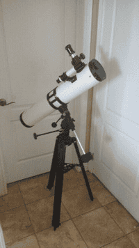

This appears to be my scope - an Orbitor 4000:
You should have some friction in the clamps, so you can physically move the telescope to a target, then allow it to track without slipping. That freedom to move, also protects the worm gear from excessive force.

DaveC426913 said:
I am wondering if I should not have greased the parts I greased.
I would wash off the grease with white spirits, then see if I can make paper washers to provide friction between the metal surfaces.
DaveC426913 said:
I find it hard to believe the axial bolt gripped the gear by friction alone (it was very tight - I had to use some gentle taps of a hammer to take the axial bolt out of the gear).
I have little idea what the pins might have done. Maybe they pinned the worm wheel in place to counter torque.

gmax137 said:
Stating the obvious: it's not going to work right until you figure out where the pins go. Put the grease question aside til then.
Yeah. They've got to be in the same hole as the manual locking knobs. i.e. per the diagram.
(Not the same as my mount, but at least we can talk to the diagram)
I'll try that tomorrow.
That seems to have done the trick. They seem to be an extension of the locking knobs. I stuck them in there and now the scope seems to work fine. We'll see how it works with first light.

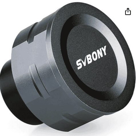

I bought this $50 SvBONY 105 as a proof of concept.
Took a while to get it working; I was afraid there was some compability issues, and I might have to pack it back up and return it.

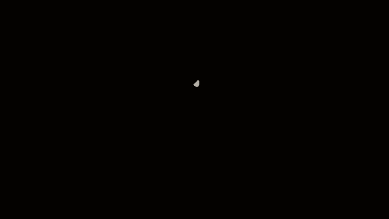

So I am pleased to see First Light:
(It's day here and the only thing far enough away to focus on is a neighbor's roof.)
The collimator has not arrived yet so it's pretty crummy alignment after sitting in storage for several years. The spider adjustor bolts are literally rattling in their sockets.
Cross my fingers I can get it all set up before Saturn's rings are completely edge-on. :-p

I've finally got some proper night viewing happening.
This is Venus:
And now I'm getting down to some nittier-grittier problems. Objects cross the camera's viewfinder in about a minute. Since my mount is manual, I have to constantly tweak it to stay in view. That's going to become an even bigger problem if I want to zoom to see more than a fat dot.
