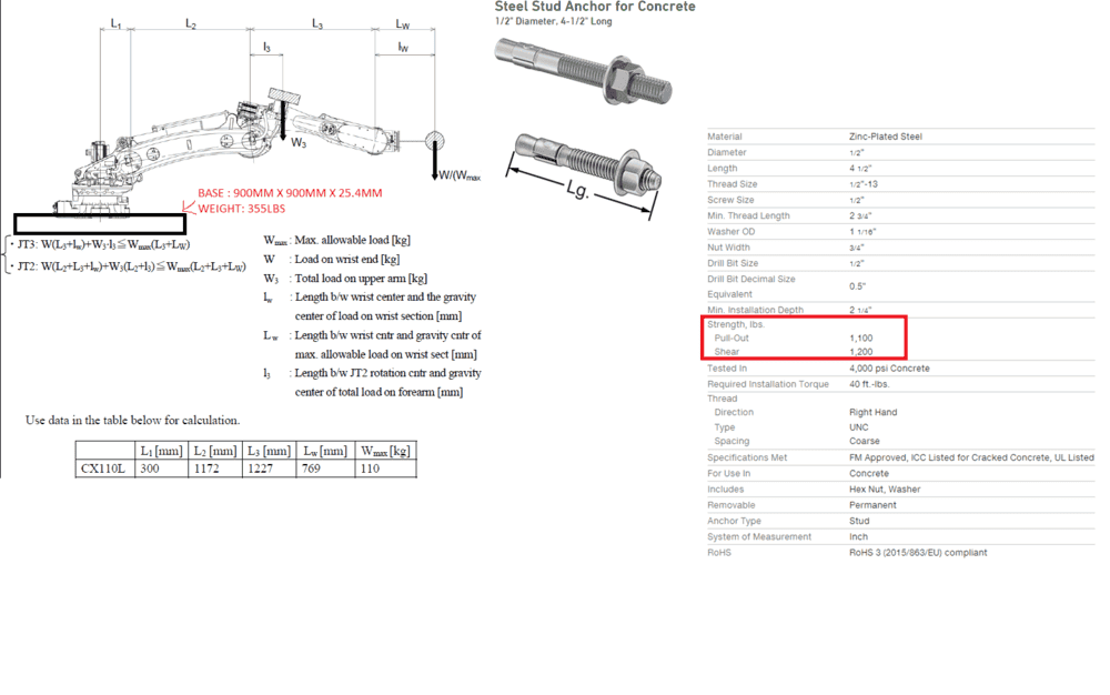

The robot weight is 900kg
I have a robot with max reach swinging around with a weight of 110kg at the end at 125 degree/s
I am not sure if the anchors I use are strong enough to hold it down assuming i mount the robot at the centre of the mounting plate
Any advice with doing calculations to do a sanity check?
I am also using M20 bolts to mount the robot to the base with 24mm thread engagement Class 12.9 bolts x 8 around the diameter Space around roughly at L1=300mm
Thanks

Hi Jeff,
The max weight in the arm will be 110kg at distance 300mm+ 1172mm+1227mm+769mm = 3468mm
the stud anchor specs are in imperial
Thanks

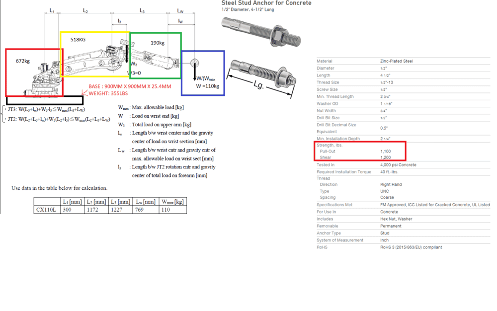

what is W3? (weight of arm)
thanks
jeff
thanks
jeff
Hi Jeff
This diagram is the correct info. W3 =0
thanks
Hello,
I am getting around 2500 lbf total just from rough calc.
so 1100 pullout of your bolts x 8pcs should be more than enough.
thats a good 350% safety factor. That is for the arm to the plate. You would need more anchors for the plate to the ground of the same strength. The force would be a little less because of the weight of that thick base.
What did you get?
(627*.3 + 518 * 1.172 + 190 * 1.227 + .769 * 110)* 9.81 = 10917.7 N = 2454.4 lbf
i neglected the 125 degree angle because this would only reduce the total force. worst case scenario is if someone puts the arm straight out.

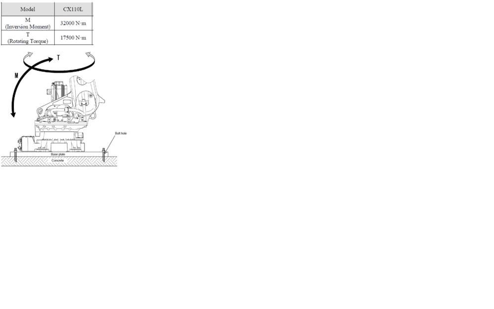

The 125 degree / second is rotational speed of the robot spinning around , wouldn't that cause a moment and require more force?
I have additional information
I have the same results in your first step but your units should be KG*M X 9.81M/S^2 = KGM^2/S^2 Which N*M = joules
Thanks
