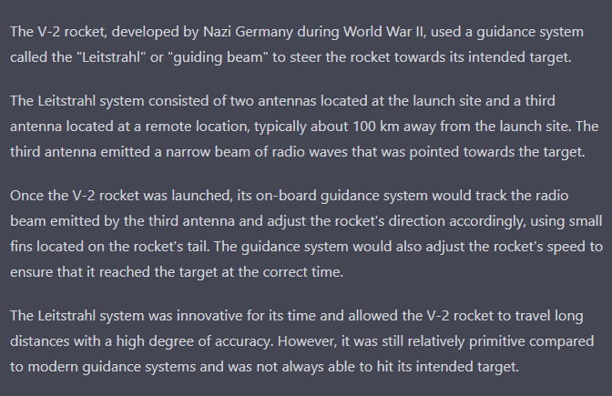

Now you may say,how are you going to guide the thing over such a distance ? Well the latter V2 rockets had very simplistic designs regarding radio guidance,at least when they took off,so we could make "antenas" all the way from the cannon to its targets,or just line up vehicles having them and crudely radio guide it.We could even have some sort of fritz x guidance system on it,have a plane fly near the end of the things journey,have the shell throw flares or tracers or something once it reaches its max range so that the plane can see it and then have the plane guide it like the fritz x bomb.That would require small wings and maybe some sort of flaps or something to slow the shell down cause i doubt the people on the plane are going to be able to guide it at very high velocities.I propose the fritz x thing since the hardest part of controling a missiles path is on the descend and since we care for accuracy i cant think of any better way for it to be done for the era.

I never said im not going to strap some wings on the thing :) Even modern ramjet artillery shells have small wings.I was baffled at first at the extreme height the shell would reach and i knew i had forgotten to say something.Basically what i aim to do with this "project" is eliminate the fuel required by a rocket booster to get the shell to an adequate enough speed for the ramjet to fire up.If i wanted to rocket boost the payload throughout its entire journey i would need a very big booster,a lot of fuel and at that point its basically a ballistic which is too costly per unit.Basically i imagine my shell as being a mixture between an artillery shell,a cruise missile and a glide bomb.The cost will be high for the guns and the whole emplacement though so its not a total win win.Im using the same arguments the people that were going to built the US SLRC used by the way :) Other than that i can only think of a rail launched missile that will be rocket boosted up until the speed the ramjet requires and then it will fly pretty much like the shell.I dont know though how much fuel will something of this kind require for the boosting and how expensive per unit will it end being due to that.The V2 was 12 tons and 10 of those were the fuel and oxidizer.
From wikipedia we read
Some later V-2s used "guide beams", radio signals transmitted from the ground, to keep the missile on course, but the first models used a simple analog computer
Dr. Friedrich Kirchstein of Siemens of Berlin developed the V-2 radio control for motor-cut-off (German: Brennschluss).[16]: 28, 124  For velocity measurement, Professor Wolman of Dresden created an alternative of his Doppler[39]: 18  tracking system in 1940–41, which used a ground signal transponded by the A-4 to measure the velocity of the missile.[3]: 103  By 9 February 1942, Peenemünde engineer Gerd deBeek had documented the radio interference area of a V-2 as 10,000 metres (33,000 feet) around the "Firing Point",[40] and the first successful A-4 flight on 3 October 1942, used radio control for Brennschluss.[15]
https://en.m.wikipedia.org/wiki/V-2_rocket Its on the technical section
I am certain that countries like the US that were far better in electronics than the Germans could make something even more reliable when it comes to the guidance.
Im gonna do the same for the shell but i will place antenas on trucks throughout the whole path of the thing so that any huge deviation can be corrected.The targets are still going to be cities or factories so we dont need to be extremely accurate but we need to at least have a handful kilometers margin of error not tens of kilometers margin of error.
Im happy that i get a little bit attention on this even though it may sound as a silly idea so thanks again to everyone that has answered my questions or expressed a criticism of any sorts thus far
This is possibly the very worse part of your not very good idea.
