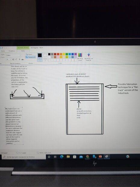

Summary:: I have to show to my university class an innovative feasible project. It's about new generation Highways, based on the Inductrack model. There are a lot of questions that I have to ask to know if it's a feasible project, so if there is someone patient that have time to answer all my questions and help me solve my issues I'll be very grateful.

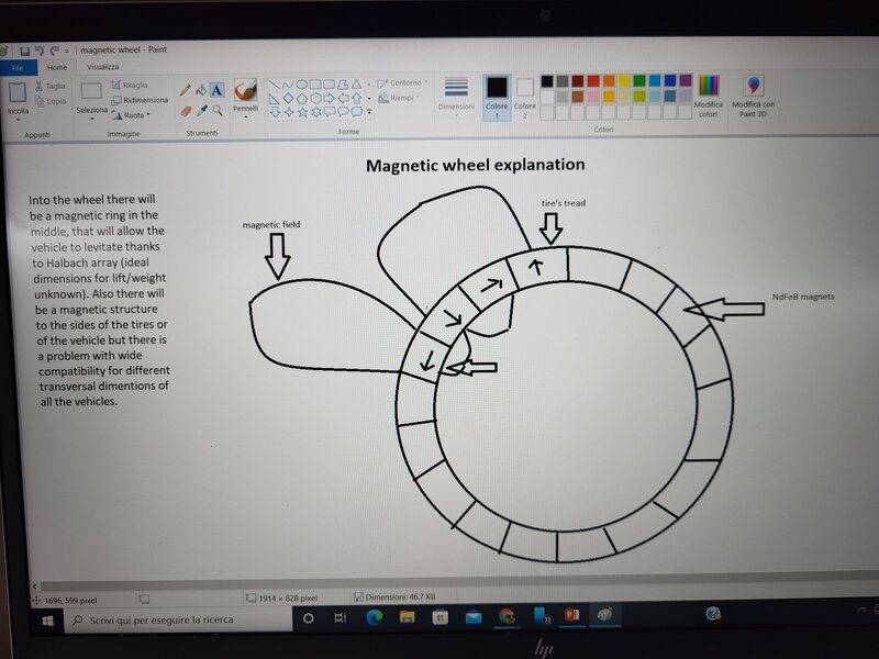

The idea is to insert in each wheel of a car two rings of permanent magnets, that will allow to levitate the vehicle on a flat track made of thin aluminum sheets covered with a pattern of laminated conductor strings shorted at their end that forms a close packed array.
My primary issues are these:
-Best structure of magnetic rings/magnets itself (dimensions, type of magnets, magnetic strength ecc.)
-Possible structure of rails with closed packed arrays for passive levitation ( how the vehicle reach stability, rail material (aluminium?), arrays structure, dimensions ecc.)
-Compatibility for most vehicles
-Feasibility study of magnetic rails splitter
-Propulsion system using magnets/electromagnets on the rail
-Brake
-Energy consume of the system for each vehicle on different speed
-Efficency of the system, L/D ratio

Thank you. So the purpose of the levitation is to convert existing highways into more efficient, eco-friendly, safe, and fast roads. A client will drive the car until it starts floating at low speed, then the user will be able to turn off the engine: a software will drive each car to the destination. Levitation is useful for the road-tyres drag. The main energy loss is needed to battle the air resistance, but I'm non considering tunnels because there have to be used special vehicles. The energy of the levitation come from a inductive loading of the flat pattern of laminated copper or aluminium strings shorted at their end that interact with the permanent magnets fixed on the vehicle. When the vehicle is moving, it levitates passively. I shared the main link that helped me with my hypothesis, I also searched few other pdf's and similar explanations.

Well to your credit, your reference it to LLNL, which is a verey credible organization. It would help if you could post some of your initial diagrams for how you envision this working. I'm still having trouble understanding how this would work (I only read the LLNL abstract), so the more diagrams the better. Thanks.

Yesterday I sent you the wrong pdf. I've also considered that one, but this one that I'm sending you now allows you to understand better my idea. I also send 2 photos with a very basic explanation of the idea.
I've posted this thread because I'd like to know ideal magnets dimensions according to the design shown in the photo following to calculations that have been already made for another similar system shown into the linked pdf. Let's say an approximate weight of 2000 kg with a medium aerodynamics value. What changes is that there is the tire's tear between magnets and track.
Also referring to the linked pdf, I'd like to know which are track's best width and thickness, and the possible distance between each conductor wire. Thank you for your time.
