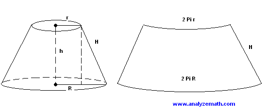

I need to make a net for a frustum. The following web page explains how to do it... http://www.analyzemath.com/Geometry/conical_frustum.html
I have tried but am unable to do this complicated, advanced (o.k basic) math.
In the following figure I have the values R,r and h.
R = 40
r = 35
h = 83

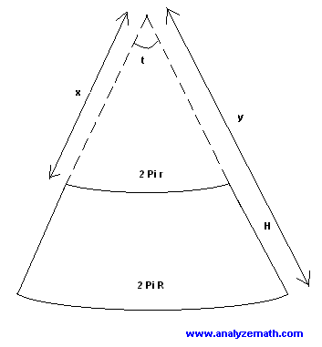

I need the values for x,y,t and H in the following figure so I can construct my net.
x = ?
y = ?
t = ?
H = ?
Can anyone please help me find x,y,t,H ?

Your internet must not be working properly. If you read on the linked article further, it gives explicit formulas to calculate x, y, and t.
H can be calculated knowing the Pythagorean Theorem:
H2 = h2 + (R-r)2
From the article:
x = r H / (R - r)
y = r H / (R - r) + H
Any of the formulas 2 Pi r = x t or 2 Pi R = y t may be used to find the central angle t (in radians):
t = 2 Pi r / x
= 2 Pi r / [ r H / (R - r) ]
= 2 Pi (R - r) / H
Since the angle t is in radians, to convert t to degrees
t in degrees = t in radians * 180 / Pi
Remember, measure twice, cut once.

x = r H / (R - r)
x = 35 x 83.15 / (40-35)
x = 2910.25 / 5
x = 582.05
y = 35 x 83.15 / (40 - 35) + 83.15
y = 2910.25 / 5 + 83.15
y = 665.2
t = 2 Pi r / x
t = 2 x 3.141 x 35 / 582.05
t = 219.87 / 582.05
t = 0.38
t in degrees = 0.38 x 180 / Pi
t in degrees = 21.78So my final values are
H = 83.15
x = 582.05
y = 665.2
t = 21.78°
Is that correct?

Your numbers look pretty good. Remember, for H, x, and, y to use consistent measurement units like inches or centimeters when laying out your net.
When you have something like
H2 = 6914
the square root is what tells you how to find H, that is, what number when multiplied by itself, gives you 6914 in this case.
Your calculator has a key that looks like a little check mark √ which is what you press after entering 6914.
