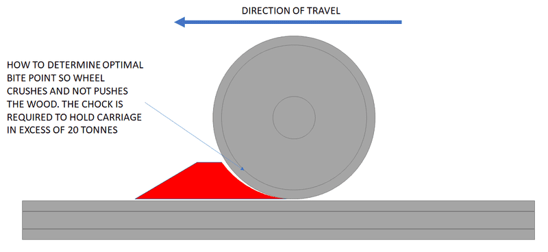

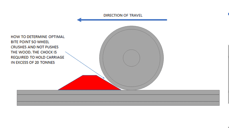

Hi all,
I am new to the forum and hoping for some help please.
I work in the rail industry and we use chock blocks to stop trains or carriages rolling. I would like to know about the technical side of how and why the chock stops the wheel from moving. Obviously it wedges the wheel to stop movement but i am keen to learn what is the optimal point in terms of angle of slope required depending on the wheel size etc. From testing them i know that too step of a slope is detrimental as the wheel pushes and not crushes the wood so the block slides along but surely there must be some calculation that determines the optimal point to wedge a wheel etc.
I have seen simpack software that looks like it could provide some insight in helping with testing and providing data etc but have no idea where to begin.
So what i am kind of asking is there anyone that can provide some insight and help teach me some basics of how to calculate stuff like this or if simpack is even the correct thing i should be looking at.
Thanks in advance

Thanks both for replies.
In terms of materials, the track is steel as are the wheel sets. The chock is steamed beech. The wheel sets range from 720 to 840mm.
I’ve added 2 very crude drawings.
The wood tends deform on the inside (flange ) side of the wheel

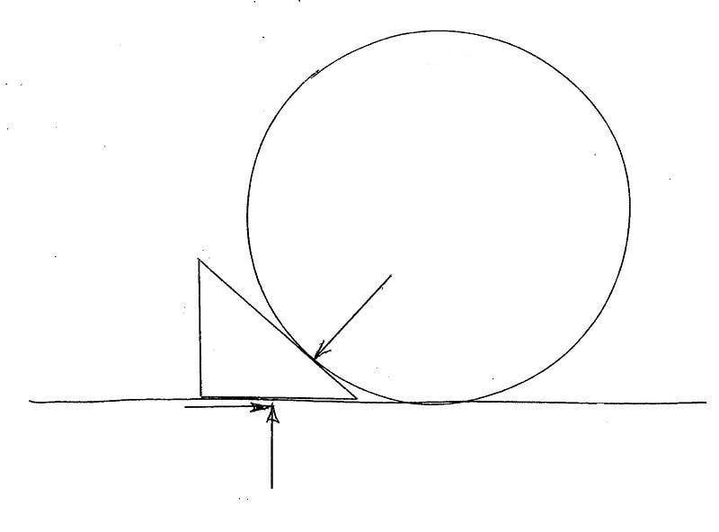

You are correct, there is a way to calculate chocks. But it can get complicated, so we start with the simplest case. There is no need for a sophisticated software package because hand methods work. We start with a free body diagram (FBD). Search that term. The Wikipedia article is a good place to start.
Below is a FBD of a wheel and chock. The wheel has a force against the chock. That force is perpendicular to the face of the chock. The ground has a force against the chock. That force has two components, a vertical force perpendicular to the bottom of the chock, and a friction force parallel to the bottom of the chock. The wheel force can be separated into two components. One component is vertical, the other component is horizontal.
Since the chock is not moving (important for this analysis), all vertical forces sum to zero, and all horizontal forces sum to zero. The vertical component of the wheel force is equal to the vertical force between the chock and the ground (or rail). The horizontal component of the wheel force is equal to the horizontal component of the force between the chock and the rail. If the ratio of the horizontal component to the vertical component of the chock/rail force is greater than the friction coefficient between the the chock and the rail, the chock slides. If less, it does not slide.
The above simplified analysis assumes zero friction between the wheel and the chock. The next step is to add a friction force between the wheel and the chock. That force is equal to the wheel force multiplied by the friction coefficient between wheel and chock, and is parallel to the face of the chock. Then sum horizontal and vertical components as above to find if the chock slides.

Thanks for this, will sit down later and go through it all. I take it you have a lot of experience in this field.

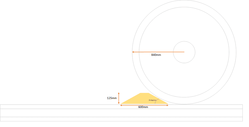

Right I've read through it and I think I kind of get it but where do I start with actual calculations in real world?
Diagram with actual dimensions. *Assume a round number for wheel force. Just get started and keep at it until you get to the end. This is one of those problems where trying to fully understand it before starting will suck you into a black hole. So just get started.
Since sliding is calculated from a ratio, the exact numbers do not make a difference. Start with 10 lbs, 100 lbs, or 1000 lbs makes no difference in the final answer.
And yes, I do have a lot of experience at solving these types of problems. So when I suggest just getting started, that's experience talking.
* Real physicists want you to do it all using letters and algebra, but people like me find it easier to use numbers.
So is this enough info to get started with?
Sorry that should 840 dia nor radius
I would have thought that the 2 different radii were for the main wheel and the flange, no? If so, the chock should be contacting the main wheel and not the flange?
Anyway, it seems like the two extremes would be a rectangular block and a very low angle wedge. The rectangular block would not work because none of the wheel pressure is transferred to the block and the block just slides down the rail with a little friction based on its own weight as the wheel pushes it along. In the low-angle wedge case, the wheel can roll up and over the wedge, so that won't restrain the train motion well at all.
In between there will be an angle (or maybe more than one) where the weight transfer from the wheel to the wedge/chock is optimum for the friction forces between the wheel and the chock, and the chock and the rail, so that the most sideways force can be resisted before something slips. It certainly seems like a curved wheel-shaped chock would work best -- is that common? It looks from the pictures like some chocks are straight and some are curved? Also, the train has to be heavy as all heck -- do these chocks ever crumple and fail?

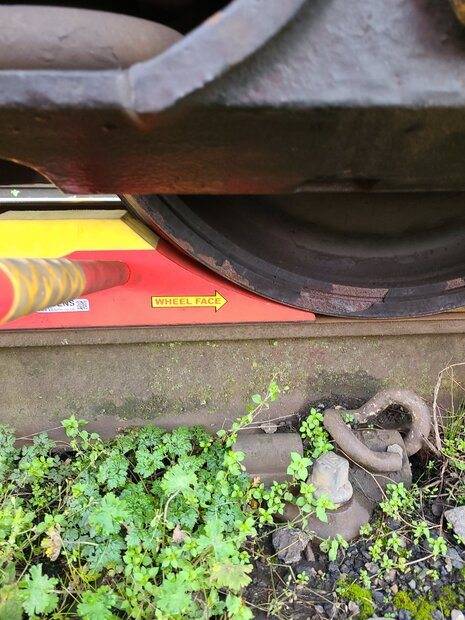

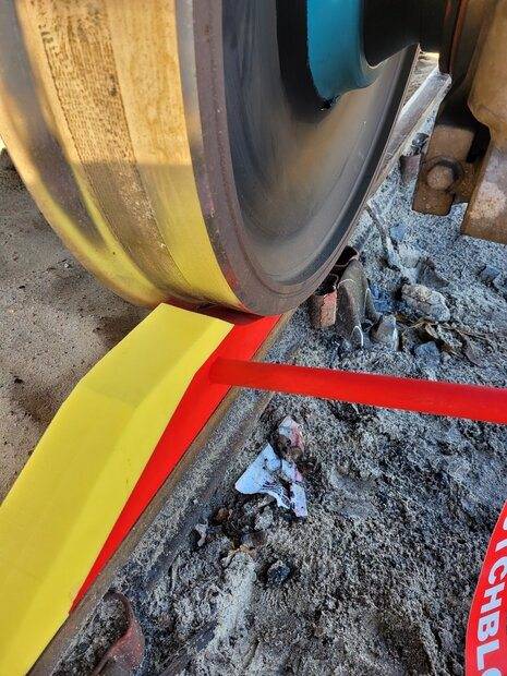

Thanks for the replies.
Maybe i need to explain a bit more how our ones are used as it might answer a few questions.
The flange doesnt come into contact with the chock at all. I will post a pic of a close up.
We use both a straight wedge and a curved variant in the industry in UK. For passenger trains each carriage is approx 20 tonnes so heavy enough.
The principle use is when a train stops in a depot for maintenance, the 2 scotches are placed on a wheelset or pair of wheels (depending on company), this is to prevent the train rolling when brakes are released to work on the train. It takes very little momentum to move a train and as such doesnt take a lot to stop it.
I have seen 3 car units move with a pry bar and few people pushing, because of this you can stop a unit moving with a small wedge.
The problem we find is they get left in place and driven over and this causes derailments although i believe we have limited this by designing a new style block. Even after being driven over the wood isnt destroyed, it is damaged but could be used over and over again. Possibly the grain of the beech as previously mentioned.
The main issue is to stop train rolling.

Curved, curve can be in contact across the length of the face of the chock. From testing this then tends to push the block along if curve is wrong for the wheel.
Also with curved the length of face causes issues as the wheel rolls up i then almost mates perfectly with the block so the contact area is the whole face which i think just pushes the block again. So again the curve needs to be shallower than the
