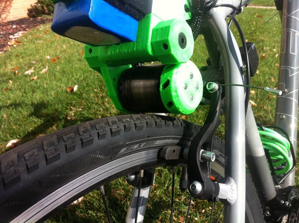

I am working on a project regarding the friction drive on bicycles. I would like to design an assembly which has to be compact enough, and has to be able to produce torque that will move the bicycle from a stationary position, but as it turns out with my calculations torque required is really high, or I am calculating something wrong?
My values:
Weight – 100kg
Bike wheel size – 26”
Torque result – 647Nm
Could you please help me find the answers (right values), or guidance in this problem as I think I am not taking into account some variables (friction value, weight distribution, etc.) that will change my result?

If you have a motor with, say, a 0.050 m radius roller r driving your wheel, you can determine the torque & rpm this way:
$$F_r = F_w$$
$$\frac{T_r}{r_r} = \frac{T_w}{r_w}$$
or:
$$T_r = \frac{r_r}{r_w}T_w = \frac{0.050}{0.33} * 11.9 = 1.8\ N.m$$
And for the rpm:
$$v_r = v_w$$
$$\omega_r * r_r = \omega_w * r_w$$
or:
$$\omega_r = \frac{r_w}{r_r}\omega_w = \frac{0.33}{0.050} * 12.6 = 83.16\ rad/s = 794\ rpm$$
Again , you can verify that the roller power is still 150 W:
$$P_r = T_r * \omega_r = 1.8\ N.m * 83.16\ rad/s = 150\ W$$

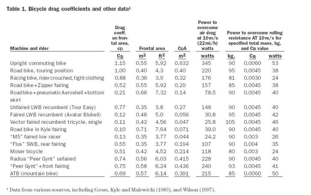

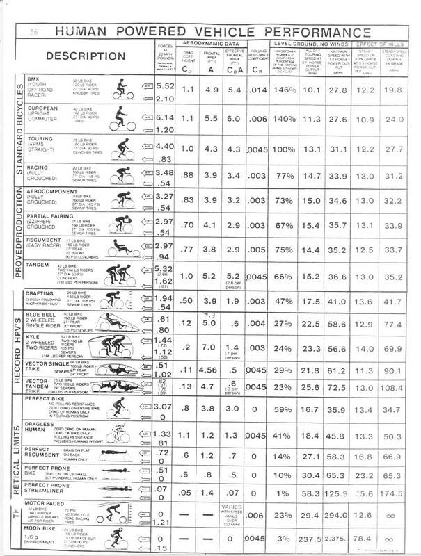

You can find typical values for bicycles by a simple google search. Here are some I found:
Note how they only care about the power required.
