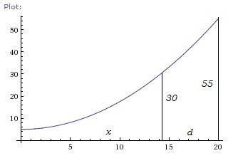

Pre-calculus, parabola problem?
A cable of a suspension bridge is attached to two pillars of height 55 m and has the shape of a parabola whose span is 40 m. the roadway is 5 m below the lowest point of the cable. If an extra support is to be placed where the cable is 30 m above the ground level, find the distance from the nearest pillar where the support is to be placed.

Let's orient our coordinate axes such that the origin is at the point 5 m below the vertex, or lowest point, of the cable. We know the axis of symmetry will be the $y$ axis, and we know the cable passes through the point $(0,5)$, and so we may write the function $c(x)$ that models the cable with:
$$c(x)=ax^2+5$$
Now, because the span between two pilalrs is 40 m., we therefore also know the cable passes through the point $(20,55)$, and so with this point, we may determine the parameter $a$:
$$c(20)=a(20)^2+5=400a+5=55$$
$$400a=50$$
$$a=\frac{1}{8}$$
Hence:
$$c(x)=\frac{1}{8}x^2+5$$
Now, we want to find the $x$ value(s) such that $c(x)=30$:
$$30=\frac{1}{8}x^2+5$$
$$x^2=200$$
We need only use the positive root by symmetry:
$$x=\sqrt{200}=10\sqrt{2}$$
Now, to find the distance from this value for $x$ and $20$, we simply subtract the $x$-value from 20 to get:
$$d=20-10\sqrt{2}=10\left(2-\sqrt{2} \right)\approx5.85786437626905$$
Here is a diagram of the parabolic function modeling the cable, and the added pillar along with the preexisting pillar:
