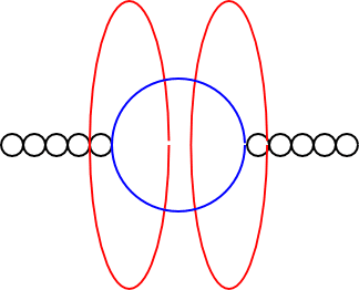

Ah.. The thing I noticed is that there is a hole in the positive strong force.
And there is a small peak in the 2nd weak force that is there from the ratio's acting on each other.
So the estimated picture from the side is something like so.
Which is the thing I find hard to alter into something else.
Might be something to encase in a mu metal of some sort so that it sweeps up higher, (if it actually does?) I guess you can also introduce a bearing of some sort to try and damp off a bit of the field. Have to go with a gut feeling there'd be some damping on both ends.
