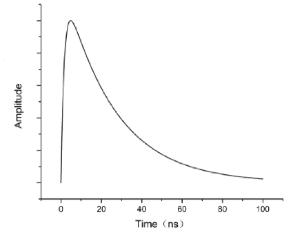

I need to select the proper switch to be used in a high-energy, high-voltage LC circuit, intended to produce an oscillatory discharge through the L element. I started my research from the already existing equipment, as it would be a waste of time and resources to re-invent something that, most probably, is already in use somewhere.
Most of you probably know already the waveform of the "classic" NEMP:
This pulse is generally obtained by discharging a Marx generator (stack of series capacitors) into a suitable antenna, usually some kind of dipole. The pulse is clearly unipolar (like the pulse produced by a real nuclear device going off), there is no ringing of the output voltage, and the current flowing through the series circuit formed by capacitors-switch(es)-antenna, is unidirectional too.
Unidirectionality is a good thing when having to use switching elements like triggered spark gaps (aka "controlled spark gaps" or "3-electrode spark gaps") or hydrogen thyratrons, because all these switches cease to conduct and reset back to high-impedance state when the anode-cathode current drops below a certain level and the ionization extinguishes.

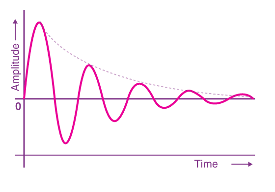

But in my case, I don't have to generate any EMP/NEMP. All I need is to discharge the capacitor(s) into an inductor, to obtain an oscillatory, damped discharge, like this:
So the circuit will be a very simple series of 3 elements: C [with its associated charger] + L + switch
(...I guess I don't need to draw it... :oldbiggrin:)
The switch is the issue.
As far as I know, a triggered spark gap or a thyratron will turn off (ionization ceases) even before the current reaches zero: it is sufficient that the current drops below the minimum value necessary to keep the ionization going. For that reason I suspect that such a switch would brutally open at (actually before) the first zero-crossing of the current, so I would get quite a remarkable - and possibly destructive - voltage spike from the inductor that finds itself suddenly disconnected from the capacitor.
Please correct me if I am writing nonsense.
So the problem is: what kind of switch may I use in such an application?

A spark gap will continue to conduct for many cycles. and will have a resistance in the order of 0.5 Ohm. This is how how high peak-power radio transmission operated at the beginning of the twentieth century.
SCRs should do it. 2 back to back with sustained triggers, or one with an antiparallel diode. Triacs probably aren't big enough, IDK.

Uhm... :rolleyes: I'm afraid I don't feel comfortable shorting (well, almost) a large capacitor charged to a few thousand volts through a semiconductor device. The multi-kiloampere pulse is still the realm of the sturdy discharge tubes. I think the SCRs should be well oversized to work reliably. Is there any model able to withstand at least 3,000 V? If not, two or more in series should be used, with voltage-equalizing resistors and more problems due to the different potentials of the various gate terminals. On the other hand, a single discharge tube does the job and is much less delicate than any semiconductor.
You are not shorting the capacitor.
There is an inductor in series with the switch, that limits the current rise-time.
