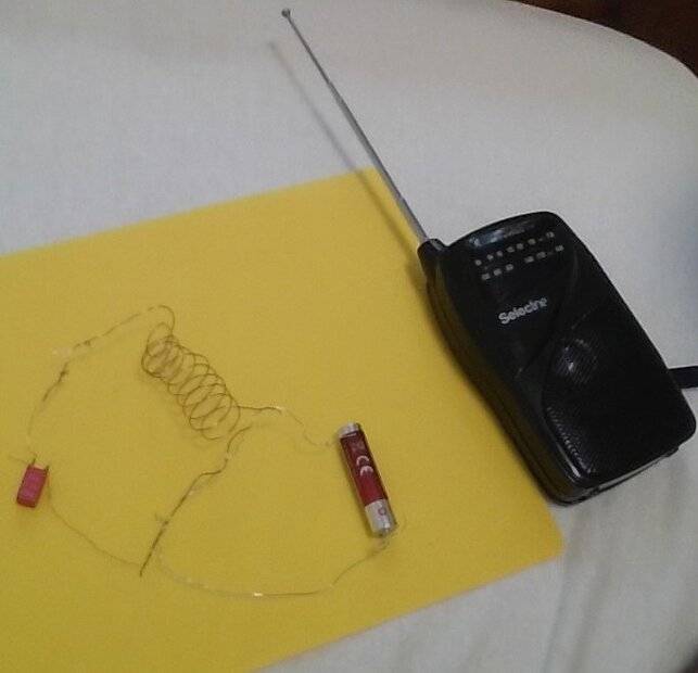

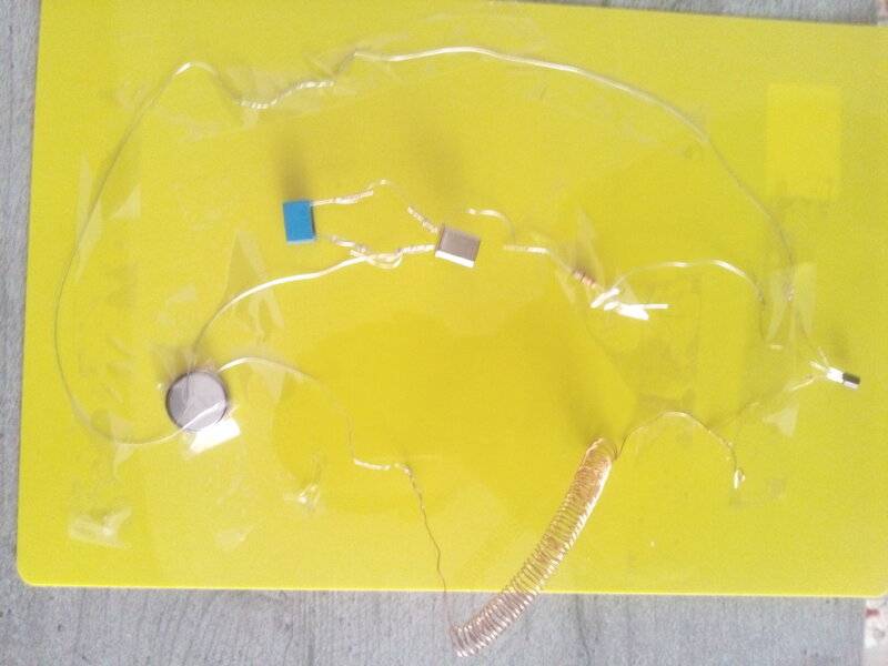

My capacitor-inductor LC circuit does not oscillate its energy between electric and magnetic field form
My inductor has 8 turns, 4 cm diameter and 4 cm length. The capacitor I use is a 1 microfarad polyester capacitor. When the copper wire inductor is connected to DC voltage the compass needle is deflected by 90 degrees and the multimeter detects 1 A or 1000 mA of current.
When DC is switched off, the magnetic field just collapses but the capacitor, although connected to the inductor in series, does not charge and discharge periodically to restore the initial magnetic field. The digital multimeter set to ammeter mode and it detects 0 mA and the magnetic compass is no longer deflected at any angle.
Same with the charged capacitor, the multimeter detects discharging it once through the inductor I mentioned but never recharging again with a opposite polarity.
Yet physics manuals mention this happens, but for my circuit it doesn't. They even compare LC oscillation with the periodic oscillation of a pendulum.
Why doesn't my multimeter and my compass detect any currents and magnetic fields once the first discharge of the inductor's magnetic field happens?
Maybe you can help me add something to the circuit to make it work like it is mentioned in all physics textbooks.

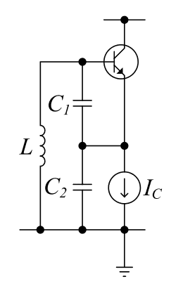

Perhaps I need something like a timer integrated circuit and a transistor to keep the oscillations from decay by switching the DC on and off before the oscillations decay?

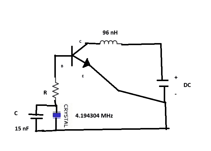

Maybe if a transistor can switch on and off the DC voltage at the resonant frequency of the LC circuit, perhaps the LC oscillations can be sustained. I think this is why they include transistors in radio circuitry?

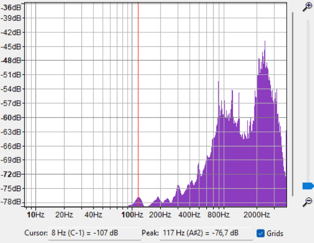

I did switch my circuit on and off and at the lowest end of AM radio band, something like a few hundred kiloHertz the radio receiver antenna picked up a short disturbance, something like a "P-r-r-r..." sound lasting a second. Only when I connect and disconnect the wire from the negative terminal of the 3 V coin battery this happens. The capacitor and inductor remain connected in series. And I did use a smaller coil.

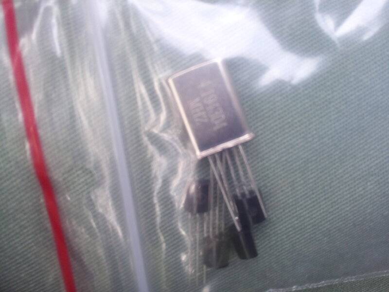

You could also use a Quartz oscillator and some transistors to switch on and off very fast

Yes i did switch on and off manually but i am planning to switch on and off very fast using the frequency of a Quartz oscillator

This is the circuit which perturbs the radio antenna at 530 - 550 KHz AM with a p-r-r sound. The capacitor is unpolarized and has 1 microfarad. Every time I graze and brush the wire very closely to the positive terminal of the battery, the antenna picks up an interference louder than its normal signal. But I am planning to use transistors and quartz crystal in the near future to switch the DC voltage from the battery on and off automatically at a very high frequency.
I think they use even smaller coils and smaller capacitances inside a FM radio.
