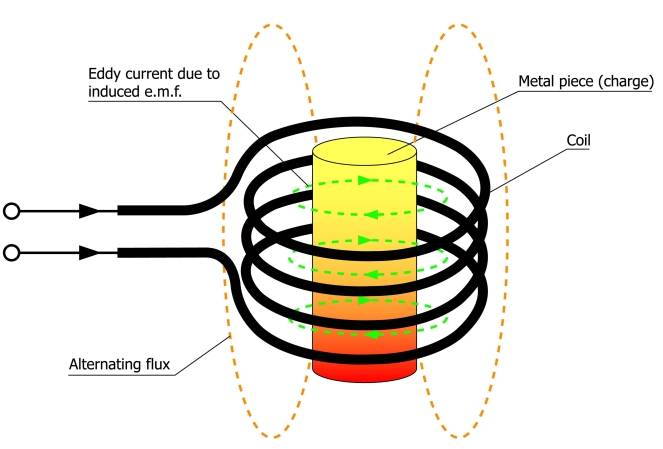

Consider Inductor with air gap and solid metal core made from material with relative magnetic permeability 1 regardless of temperature (such as copper or aluminium).
There is Air gap between coil and metal core
Please Also consider Eddy currents in the solid metal core.
The Inductor is connected with capacitor in
Series LC circuit
Parallel LC circuit
Is it possible under certain values of frequency and capacitance to obtain lc resonance with high q factor?

No. The eddy current heating of the core will be significant, and so will preclude a high Q. But then your definition of high Q may be different from mine.
An LC tank circuit could be driven to oscillate at its resonant frequency, but the active oscillator element would need to make up the energy lost to the eddy currents in the core.

Let's say Is it possible with certain values of Capacitance and Frequency to obtain Resonance with Q above 20 for the given LC Circuit?
Why would you say that?
You could design it to have a Q of 20.
What are the dimensions of the coil and the core?
Why is Q relevant?

With current Inductor with Solid Metal Core and the Eddy currents. Is it possible to have Q above 20. Inductor(with solid metal core) , Values of Capacitance of the Capacitor (Switched in Parallel or in Series) and input Frequency
