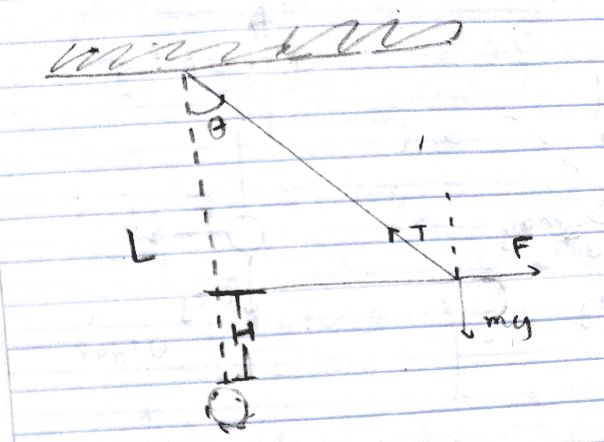

The sphere of mass 𝑚 of a pendulum of length 𝐿 is initially held vertically. When a wind blows with a constant force 𝐹 non-conservative, show that if the sphere starts moving from rest, the maximum height it reaches is
H=2L/(1+(mg/F)^2)
L(1-cos(&))=Hmax
I have tried to use the intial velocity v=(2gH)^(1/2) and tried to use conservation of energy, using potential energy to find the maximum height but still can't arrive to the answer provided. Don't know what concepts are relevant here, apparently I can't use velocity neither cosine or sine. I can understand that a bigger force will rise higher the pendulum but, How do I write that mathematically? The way I was approaching the problem, always used velocity, but can't jump from velocity to acceleration or force without having time

Can you show us your Free Body Diagram (FBD) for the mass when it is as some angle ##\theta## while being blown sideways by the wind? Use the "Attach files" link below the Edit window to upload a PDF or JPEG copy of your FBD. Thanks.
Yes! The initial velocity is zero, what I meant by v=(2gH)^(1/2), is that I supposed once the wind stopped blowing the pendulum would start to swing, since it swings to its maximum height on every end. It would fall from the right and have a velocity at its lowest point v=(2gH)^(1/2) and raise again but on the other side, the left side. So I took the new velocity as my initial velocity and I tried to calculate how far it would rise on the left side, because it would be equal to the same height it raise on the right side, when the intial velocity was zero. By free body diagram do you mean the one that I made? Because the problem doesn't gives you one.
Yes, one that you draw. Most problems like this will not do the FBD for you; that is often the first step in your solution of the problem, and usually will give you insights into possible ways to set up the equations to solve the problem. :smile:

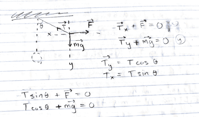

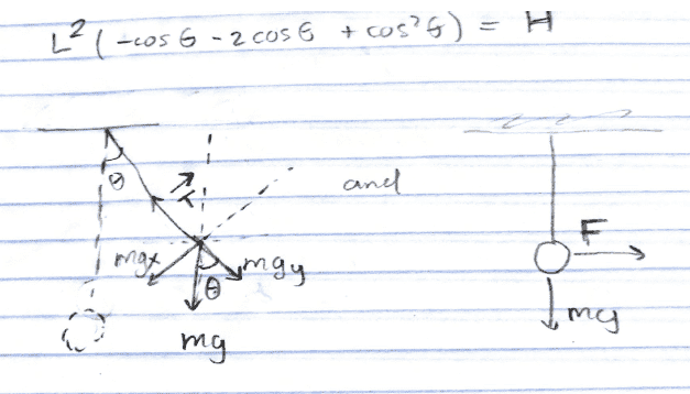

I made this two
jackkk_gatz said:
I made this two
Where is the force F in your first diagram? What is the sum of the forces on the pendulum bob when it gets to its highest point?
-Dan
jackkk_gatz said:
I made this two
That's a start. You can define your x and y axes however you want and you should still get the right answer, but it's more traditional (and more intuitive for me) to define the y-axis pointing up and the x-axis pointing to the right. Could you try re-drawing the left diagram using that definition of the axes, and then write the sum of forces in the x-direction and also in the y-direction? When the wind is blowing continuously and holding the mass out steady at an angle ##\theta## with respect to the vertical y-axis, what do those two sum-of-forces equations have to equal?

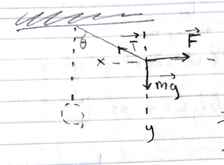

Is this correct? If so, I used some algebra and now I have cos(&)/sin(&)=mg/F. But I'm not sure what to do with that, I could find the angle only if I could use the inverse of the trigonometric functions.
Good, I got the same equations. Now we look back at the original question, and see that we need to solve for H, the height along the y-axis that the mass rises to. So add in the lines on your FBD to show what H is, and think about how to write the trig equation for H and how to use your equations to isolate H for the solution to the problem...
BTW, you diagram is not quite to scale to show H, so maybe just redraw it to show the mass at the distance L for ##\theta = 0## initially and the final ##\theta## position/value.

Are you both treating this as a statics problem? That's not how I read it.
@jackkk_gatz , you need to consider the general situation, i.e. with the sphere still being accelerated. What equations do you get for that?

Do you mean something like this? lengthen horizontal lines to see the height on the y-axis?
Oh, interesting point! I was treating it like the wind blew the mass up to some steady-state height, but I see your point now that it may be a more dynamic problem where the mass initially makes it a bit higher than the steady-state position and then oscillates/settles into the slightly lower final position.
Back to the drawing board...

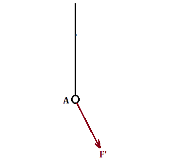

There are different ways to approach this problem. Here's one way that you could consider. The gravitational force mg and the wind force F add as vectors to produce a total constant force that we could denote F'. This force F' acts like an "effective gravitational force" in a "tilted" direction.
The pendulum is "released" from position A. Can you describe the motion of the pendulum assuming F' remains constant in magnitude and direction?

View attachment 314035The pendulum is "released" from position A. Can you describe the motion of the pendulum assuming F' remains constant in magnitude and direction?
Isn't that a similar approach to the first ones mentioned? I suppose that F' would make the pendulum stop at a certain point, where the angle of F' and the angle of rope to respect the vertical, would have the same magnitude.
Wait I think I get it, the angle that F' forms is just half of the angle that the pendulum would form at its highest point? If i treat it like an effective gravity I think that's how it should behave, and if so, why does it behave like that? Because of momentum?
Yes
Yes. It behaves just like a regular pendulum, except that it oscillates about the configuration where the string and F' are colinear. The inertia of the bob keeps the bob moving past this configuration.
