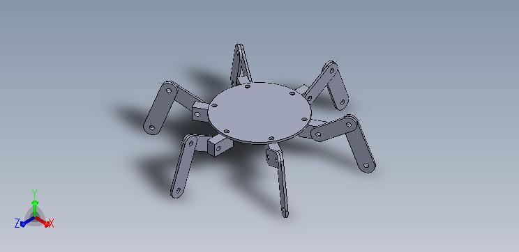

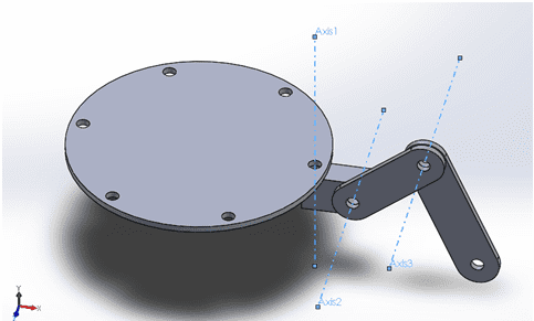

I am making a hexapod ( six legged walking mechanism ) which walking by keeping 3 alternate legs in air and other 3 on ground, pushing the body ahead, also known as tripod gait. The basic structure of model and one leg are shown in the pictures. I want to calculate the torque requires by servo whose axis is alligned to axis1, i.e. hip joint. Hip joint of 3 alternating legs will act together to push the body forward. I have calculated the angles of rotation and mass moment of inertia of the whole structure.
Torque= I x alpha
Can I simply use the above formula? I think i will have to divide the Inertia by 3 as 3 hip joints will act together.
If you imagine the motion, alternate 3 legs on the ground forming a triangle rotate about the tip touching the ground due to rotation of hip joint about axis 1.
I am a confused how to approach this problem.
Looking forward to the solution!
Thanks :)

Welcome to PF.
The legs you have drawn appear to have planar hip and knee joints so I do not see how it can walk anywhere in 3+3 mode. I guess you will sort that out later.
There are two things at play here. The moment due to the static body mass and the position of the leg must be countered by torque from the servo motor, and the dynamics of the leg components and body movement. The static moment is not a "moment of inertia" which is only needed for dynamic computations. Here I consider only the static force.
Consider the body mass, m, typically one third, m/3, will be carried by each leg as a force, f = m/3 * g. The horizontal distance, d, along the surface from below the hip to the foot contact is effectively a torque arm. The moment at the hip will be m/3 * g * d. That assumes the foot does not slide on the surface.The worst case value for d will be the total length of the leg.
It gets more complex if you include the mass of the leg components in the static calculation because the position of the centroid of each leg will decide how the leg mass is distributed between the foot and the hip. Then there is also the mass of the servo actuators etc.

A human hip joint is a ball and socket joint. You show only one degree of motion possible in the robot hip joint.
Once the three feet are placed on the surface there is no possibility of horizontal body movement without foot slip.
The centre of the body must remain above a fixed point on the surface. Rotation of the body would not be possible.
If movement is prohibited by insufficient degrees of freedom in the structure then there can be no dynamics analysis.
