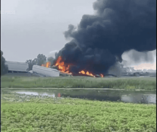

ABC News published a video of the NS train derailment in Ohio. At a highway grade crossing, something happened at the upstream side of the crossing. A coil flat car (the trailing one of two cars in a set of coil flat cars) looks like it's leaving the rails. It pulls the leading coil car off the tracks with it, and the subsequent rail cars, including two tank cars, a centerbeam flat car (for building products), and others come off the rails as well. NTSB will have to look for an obstruction on the track, a broken rail or joint, dangling equipment on the freight car and possible broken wheel, bearing or axle.
Another driver with a cellphone or dashcam caught the derailment from the other side of the tracks.
Looking at the video several times, it appears several freight cars traversed the crossing without problem (they stayed in the rails). That would indicate a problem with the rail car that derailed.

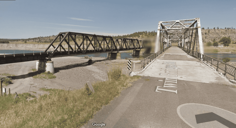

BNSF's Yellowstone River Bridge (near Reed Point, MT) is out of service after it collapsed under a BNSF train, and the parallel automobile bridge (Twin Bridges) is temporarily closed. It is a main line for BNSF between Billings and Bozeman. The bridges are located in Stillwater County, between Reed Point to the west and Columbus to the east. One could see the bridges from I-90.
https://www.yahoo.com/news/train-derails-yellowstone-river-prompting-165417989.html
https://www.ktvq.com/news/local-new...acility-plant-shutdowns-in-yellowstone-county
I appears high water (and high flow) in the Yellowstone River undermined one of the piers in the middle of the river. Attached image shows what the bridge normally looks like at low water and before the collapse.
Stillwater county is experience flooding along some streams south of Columbus, MT.

It appears high water (and high flow) in the Yellowstone River undermined one of the piers in the middle of the river.
Ah, I missed that in my earlier news report readings today. Those reports did say that they had high waterflow recently, but it was not known if that contributed to the collapse. Still, you have to wonder how a bridge design got approved if it can be so affected by high river waterflow. It looks like a short bridge, so likely only a single center support that was pile-driven into the riverbed?
  • #40
I don't know. I believe it was stone and concrete. I was looking for details.
It could have been built in 1897. A similar bridge on the railroad collapsed last year (2022) in Park County.
The highway bridge was apparently demolished, which is why it does not appear in current images of the collapsed railroad bridge.
https://www.ktvq.com/news/local-new...-bridge-near-reed-point-in-danger-of-collapse
https://www.montanaoutdoor.com/2021/05/yellowstone-river-to-reopen-at-two-bridges-road-bridge/
Apparently, heavy scouring undermined the piers of the highway bridge.

Rail cars carrying hazardous material derailed and burst into flames Friday in a remote area of North Dakota, but officials said no one was hurt and the threat to those living nearby appeared to be minimal.
Twenty-nine cars of a CPKC train derailed around 3:45 a.m. in an area surrounded by farmland that’s about 140 miles (225 kilometers) northwest of Fargo, said Andrew Kirking, emergency management director for Foster County.
The cars were carrying anhydrous ammonia, sulfur and methanol, said Bill Suess, spill investigation program manager for the North Dakota Department of Environmental Quality. The ammonia was the biggest risk, but wind was carrying the smoke away from the nearby town of Bordulac, which has about 20 residents.
https://apnews.com/article/train-de...north-dakota-a45add68f13836222234a5eb6e25693a
North Dakota Department of Transportation and Department of Environmental Quality will have to investigate.

Not a derailment, but a bridge collapse, although it was close to involving a derailment. "There are reports that the bridge collapsed shortly after a train crossed it and while the automated system was in the process of raising it to allow boats to pass below." This will require an investigation as to why it was not detected earlier.
CN said in a statement to website operator Dougall Media on Wednesday, Aug. 14, that it was responding to “an incident” involving the bridge across the Rainy River that provides its connection to the Port of Thunder Bay, Ont., and that the waterway was blocked. The railroad said no train was involved in the incident and that the cause was under investigation.
https://www.nwonewswatch.com/local-news/railway-bridge-collapses-near-fort-frances-9352179
https://www.northernnewsnow.com/2024/08/15/five-mile-bridge-collapses-fort-francis-ontario/
https://www.cbc.ca/news/canada/thun...lapse-near-fort-frances-ont-cn-says-1.7295211
https://www.startribune.com/canadia...-from-international-falls-collapses/601112356
The bridge was built 1908 By Builder/Contractor: Ketler-Elliott Company of Chicago, Illinois and American Bridge Company of New York, New York and Engineer/Design: Scherzer Rolling Lift Bridge Company of Chicago, Illinois
https://historicbridges.org/bridges/browser/?bridgebrowser=ontario/rainysub/
The bridge is 116 years old. The bridge is a Metal 6 Panel Rivet-Connected Warren Through Truss, Movable: Single Leaf Bascule (Rolling Lift) and Approach Spans: Metal Deck Girder, Fixed
