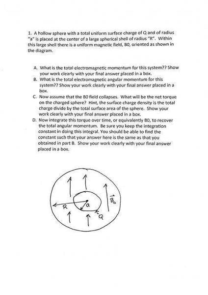

Hollow Sphere with Uniform Surface charge
woprxcpe1704tks
Handwritten-style diagram of a hollow charged sphere of radius a inside a larger spherical shell of radius R, with uniform field arrows labelled B0 pointing upward inside the outer shell, and the charge labelled Q.
[/B]
Poynting's Theorem S = 1/μ0 (E x B)
Momentum = p = μ0ε0 ∫ S dτ
My strategy was to treat the hollow sphere as a point charge (by Gauss' Law), so E = 1/4πε0 Q/a2. I believe the magnetic field would be B = 2/3μ0M (where M is the magnetic dipole moment per unit volume). For part A, would this be the correct total electromagnetic momentum if I used the formula stated above and the relevant E and B fields. Also, do I have the E and B field formula's correct?
The attachment is my current attempt at part A
