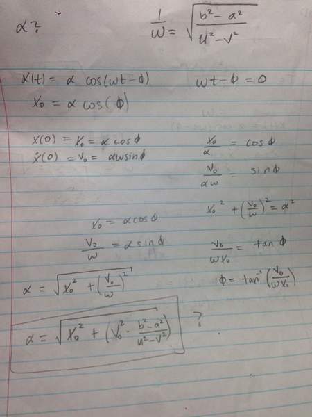

  • Photo of a printed textbook problem on lined paper: a particle in simple harmonic motion has speeds u and v at displacements a and b from its mean position; show that T = 2π((b² − a²)/(u² − v²))^(1/2), then find the amplitude.

  • Handwritten notebook derivation of simple harmonic motion amplitude: x(t) = α cos(ωt − φ), with x0 and v0 relations, leading to α = √(x0² + (v0/ω)²) and a boxed final form with ω² replaced by (b² − a²)/(u² − v²).

Disregard the tangent stuff on the right I tried doing something else...
I would be able to read your attempt if it was typed in.
Such problems are solved by eliminating the unknown amplitude by using sin2(ωt)+cos2(ωt)=1
ehild
By the way, you weren't to see my pictures? Mhm.
You are supposed to type in your work. I can not decipher what you did from the pictures.
Do the same you did when eliminating the amplitude, but eliminate omega this time.
ehild.
It is x=Asin(wt) and dx/dt= Aw cos (wt). The displacements and speeds are given at two different times.
a=A sin(wt1) u/w=Acos(wt1) -->a2+( u/w)2=A2
b=Asin(wt2) v/w=A cos(wt2) -->b2+( v/w)2=A2
Eliminate the angular frequency this time.
ehild.
