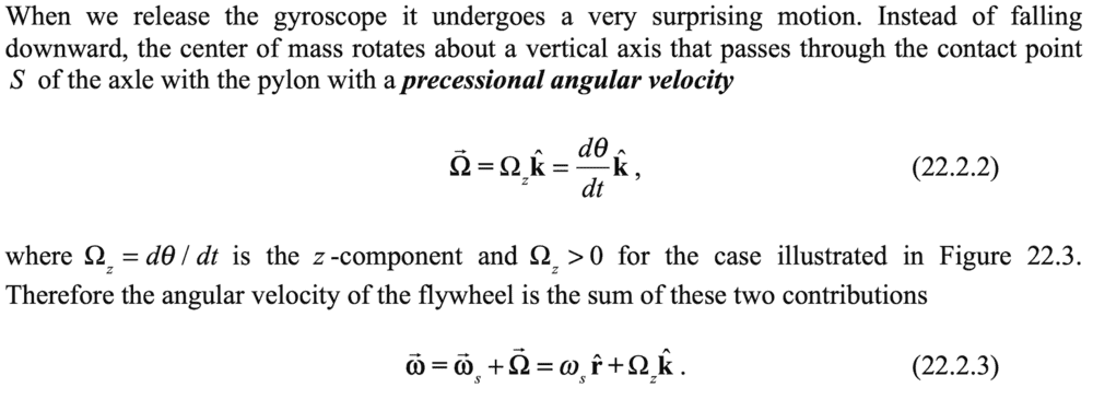

I've seen ##\vec{\omega}## and ##\vec{\Omega}## used; I think the first generally refers to the spin angular momentum mentioned here
wrobel said:
DEFINITION. The vector ##\boldsymbol\omega## is referred to as the angular velocity of the rigid body
whilst ##\vec{\Omega}## perhaps refers to the orbital angular velocity, i.e. that of the centre of mass wrt another point.
Since we know that the total angular momentum equals the sum of the orbital and spin angular momenta $$\vec{L} = \vec{L}_{\text{COM}} + \vec{L}_{\text{wrt. COM}}$$ I'd imagine it would make sense to define something like $$\vec{\omega}_{\text{total}} = \vec{\Omega} + \vec{\omega}$$ but I'd need to play around with it for a little while to check. Furthermore, I don't know whether ##\omega_{total}## would be a physically useful quantity.
Also, for angular acceleration we know that $$\vec{\Gamma}_{O}= \boldsymbol{I_{O}}\vec{\alpha}$$ Does this equation only then hold if ##O## is a point on the rigid body? Since I can't imagine ##\vec{\alpha}## has any interpretation if ##O## is fixed elsewhere!
From $$\vec{\Gamma}_{O}= \frac{d\vec{L_{O}}}{dt} = \boldsymbol{I_{O}} \frac{d\vec{\omega}}{dt} = \boldsymbol{I_{O}} \vec{\alpha}$$ since ##\vec{\omega}## is only defined for the rotation of the rigid body as a whole?
etotheipi said:
Furthermore, I don't know whether ωtotalωtotal\omega_{total} would be a physically useful quantity.

Alright, I think I've gotten a bit further. We know ##\vec{\Gamma}_{ext} = \dot{\vec{L}}##, since internal force pairs will produce equal and opposite torques that cancel each other when evaluated from any origin chosen. This applies so long as the origin is one of an inertial frame.
We also have from König's theorem, ##\vec{L} = \vec{R}\times\vec{P} + \vec{L}_{CM}##, and we can derive wrt time to obtain $$\dot{\vec{L}}_{CM} = \dot{\vec{L}} - \vec{R} \times M\ddot{\vec{R}}$$ since ##\dot{\vec{R}}\times \dot{\vec{R}}## is the zero vector in the second term of the chain rule! This becomes $$\dot{\vec{L}}_{CM} = \sum_{i} (\vec{r}_i - \vec{R}) \times \vec{F}_i = \vec{\Gamma}_{CM}$$ So essentially, as a special case, the total torque on a rigid body relative to the centre of mass equals the rate of change of angular momentum evaluated at the centre of mass - even if the centre of mass is at rest in an accelerated frame. This is not true for other points on the rigid body, since they are in accelerated frames.
As far as I am aware, the quantity ##\vec{L}_{CM}## is the spin angular momentum, and ##\vec{L}_{CM} = I_{CM} \vec{\omega}## where ##\vec{\omega}## is the quantity @wrobel defined all the way back in post #2.
And consequently ##\frac{\vec{L}_{CM}}{dt} = I_{CM} \frac{d\vec{\omega}}{dt} = I_{CM}\vec{\alpha} = \vec{\Gamma}_{CM}##, where ##\vec{\alpha}## is again a property of the rigid body (I'm not sure if it has a specific name - "spin angular acceleration?").
Now we might step back and consider a rigid body performing some arbitrary motion relative to an inertial frame, in which we've chosen an origin. We can still evaluate torques relative to the centre of mass and equate these to the rate of change of angular momentum wrt the centre of mass.
However, now we also have to take into account the orbital angular momentum, ##\vec{R} \times \vec{P}##. I start with $$\vec{\Gamma}_{ext} = \dot{\vec{L}}$$ I assume that the ##\vec{L}## in this expression refers to the total angular momentum evaluated from the origin. Now ##\vec{\Omega}## is the the orbital angular velocity vector. I had a few queries about this part
  1. Can we write ##\vec{v}_{CM} = \vec{\Omega} \times \vec{r}## relative to the origin, (i.e. as well as ##\vec{v} = \vec{\omega} \times \vec{r'}## relative to the centre of mass)
  2. How do we relate the external torque to the rate of change of orbital angular velocity?

Consider the Earth rotating around the Sun. The Earth rotates about its axis with angular velocity ##\vec{\omega}_{1}##, and the Earth about the sun with angular velocity ##\vec{\omega}_{2}##. Then it would seem the total angular velocity of the Earth is ##\vec{\omega}_{1} + \vec{\omega}_{2}##.
But now consider a rod rotating about a hinge. The angular velocities of the centre of mass and that of the rod about the centre of mass are both equal, ##\omega##. Their sum definitely does not equal the angular velocity of the rod about the hinge, which is also ##\omega##. So what gives?
Why would you add those two? The Earth is not a rigid body with a fixed point anchored to the sun. Its revolution rate around the sun (or any other form of fancy translation it might undergo) is irrelevant to its rotation rate.
Possibly you are thinking of adding the rotation rate of the Earth relative to a noontime marker pointing directly at the sun (the solar day) to the similarly-directed revolution rate of the Earth about the sun (the year) to get the rotation rate of the Earth relative to a fixed background (the sidereal day).
But that's silly. If you are making up a thought experiment, why would you pretend-measure a rotation rate against a rotating reference when it is just as easy to pretend-measure a rotation rate against a non-rotating reference.
The rod is a rigid object. For a rigid object, the rotation rate of any pair of fixed points on the object about one another will be the same as for any other pair of fixed points. The hinge and the center of mass are one pair of fixed points. The center of mass and an arbitrary other point on the rod are another pair of fixed points. Of course, the two rotation rates will match.
Yes, of course not. It gives double the rotation rate of the rod. ##\omega + \omega = 2\omega##
As @jbriggs444 points out, simply adding angular velocites around different centers is not of much use, unless you combine it with the radius vectors:
`I agree it makes little sense, however I was reading through some lecture notes about gyroscopes and came across stuff like the following (a flywheel rotating about its axis with angular speed ##\omega_{s}##, and this axle is rotating about a vertical axis with angular speed ##\Omega##).
