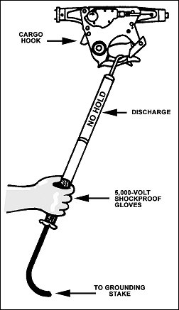

Chinooks DEFINITELY charge their rotors. However, like I mentioned, they do have some trailing wicks on the landing gear tucked in between the tires. If they do discharge on landing, it definitely is not large enough to see with the naked eye. I have seen, plenty of times, what happens when someone trying to hook up an external load on the ground and does not follow proper grounding procedures (http://www.globalsecurity.org/military/library/policy/army/fm/3-21-38/image470.jpg and http://www.globalsecurity.org/military/library/policy/army/fm/3-21-38/image471.jpg). The static discharge is enough to knock you on your butt. It hurts...a lot.
We also had a hand held device called a shepherd's hook inside the aircraft. If we had to hook up an external load ourselves, we would use the shepherd's hook to grab the clevis to the sling through the hell hole. The hook was grounded to the structure of the aircraft. I assume that the entire fuselage acts like a large Faraday cage.
