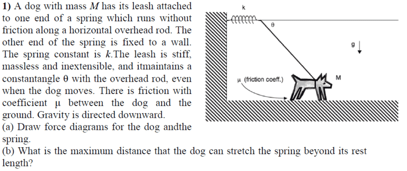

How can energy equations be applied to solve this problem?

All of them in the picture attached.
Energy and work equations;the change of the energy is equal to work done.
ACtually,I don't know how to appy these equations if you can draw the forces and relationships and how to apply them into equations the logic behind it,I would be appreciated.Thanks.

I think it's not the best idea to solve this task using energy and work. Maybe it would be easier to use the 1-st Newton's law (for solving the b) task):
the friction forse is: mu*(Mg-k*x*sin(theta)), and it is equal to k*x*cos(theta)
