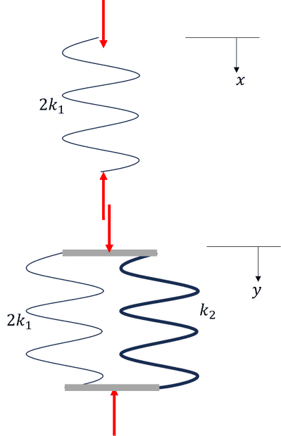

Are you saying this cannot have a solution where the system deflects some distance ##h## before instantaneously coming to rest?
$$ 2 mgh = \frac{1}{2}(k_{\text{eff}}) y^2 + \frac{1}{2}( 2k_1) x^2 $$
Where:
$$ k_{\text{eff}} = 2k_1+k_2 $$
$$ y = \frac{h}{2+\frac{k_2}{2k_1}}$$
$$ x = h - y $$
And that would presumably be because of this definition for ##k_1 = \frac{mg}{2h}##? I'll try to see if I can carry this out to failure. Or maybe something wrong with applying work-energy the way I have?
Where:
$$ x = h - y $$
You are missing that x and y are restricted to return the same force in the respective strings (they must convey the same for e due to force balance on all parts of the ideal massless springs).
You are better served finding the effective spring constant of the full system.
I feel like I used that to arrive at the equation for ##y##.
I say:
$$ y \left( 2k_1 + k_2\right) = 2 k_1 x $$
Thats just saying the red forces in the diagram are the same magnitude

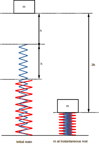

Problem statement
[Edit. Posted in case it's useful to anyone - it's one possible interpretation - an expansion of a previous interpretation, e.g. see @haruspex's Post #23.]
Spring-1 (S1), shown blue, has a spring constant ##k_1 = \frac {mg}{2h}##.
Spring-2 (S2), shown red, has a spring constant ##k_2##.
S1’s natural length is greater than S2’s by an amount ##h##. S2 has a larger diameter than S1 so that S1 fits freely inside S1 as shown.
A mass ##m## is released from height ##h## above S1 and comes to instantaneous rest after descending a total distance ##3h##, compressing both springs.
Express ##k_2## in terms of ##m, g## and ##h##
_________________
Solution (Edit - solution removed.)
Where:
You are making the same mistake as the OP that I noted in post #16.
The energy stored in compressing a spring an extra ##y## is not ##\frac{1}{2}k y^2##; it is ##\frac{1}{2}k ((x+y)^2-x^2)=\frac{1}{2}k (2xy+y^2)##
Steve4Physics said:
I hope this helps.
________________________
Problem statement:
_________________
Solution (click spoiler):
The mass descends a distance ##3h##. S1 is compressed by ##2h##. S2 is compressed by ##h##.
GPE lost by mass = ##3mgh##.
EPE gained by S1 ##= \frac 12 (\frac {mg}{2h}) (2h)^2 = mgh##.
EPE gained by S2 ##= \frac 12 k_2 h^2##
##3mgh = mgh + \frac 12 k_2 h^2##x ..some simple algebra.... ##k_2 = \frac {4mg} h##
I don’t think anyone was doubting the solution to that interpretation of the problem except the OP. The discussion has evolved into arguing if that is the correct interpretation of the problem or not (me seeing it as the natural interpretation and @erobz arguing for a different one).

No he is not. He is defining x as the compression of the first half of the long spring and y as the compression of the parallel of the second part of the long spring and the short spring.

The diagram in post #39 appears to show one spring being compressed by x, then that spring being compressed a further y as the short spring is simultaneously compressed by y.
Regardless of that, look at the equations:
Where:
I.e. $$ 2 mgh = \frac{1}{2}(2k_1+k_2) y^2 + \frac{1}{2}( 2k_1) x^2 $$
$$=\frac{1}{2}(k_2) y^2 + \frac{1}{2}( 2k_1)( x^2+y^2)$$
So did something get compressed by ##\sqrt{x^2+y^2}##?

haruspex said:
Sorry, I don’t know what that is saying. How do you compress a parallel of something?
The parallel coupling of the small spring with half of the longer spring - which is the problem interpretation @erobz was proposing. It should be clear based on that.
No, this is an incorrect description of the problem @erobz was solving. Please see his posts and my replies to them for the actual interpretation he was proposing (which we have now effectively killed off as it would be impossible to get the correct maximal compression)
No, you are misrepresenting the problem interpretation @erobz was attempting to solve. The ##2k_1## is the spring constant of each half of the longer spring. One of those halves is compressed by x and the other by y so the total energy stored in that spring is ##k_1 x^2## in the first half and ##k_1 y^2## in the second. The short spring is compressed by y so the energy stored in it is ##k_2 y^2/2##.

palaphys said:
a mass is released from a height h on top of a spring,
On top of? That suggests being in contact. Do you mean above?
palaphys said:
to which a shorter spring is fixed at the bottom.
Fixed to what and how?
palaphys said:
The mass descends down the system and at one point attains equilibrium before maximum compression,
It will pass through the equilibrium point before reaching maximum compression. Is that what you mean?
palaphys said:
which is given as h.
What is given as h? Maximum compression?
Please confirm or correct one of the clearly spelt out interpretations to be found in this thread, such as post #23.
palaphys said:
to determine the equilibrium position, we must consider a reference level of 0 gravitational potential, as probably the place where compression is maximum.
No idea what you mean by that. Where you set the PE reference level is irrelevant so long as you are consistent.
palaphys said:
Next, consider an additional compression x of the second spring in the downward direction. At this position, assume equilibrium.
Here the compression of the longer spring would be x+h . Now, solving for x becomes simple. X turns out to be h/9. What this means in practice, is that the block attains MAXIMUM velocity at this position,
Yes, since equilibrium is where there is no net force on the mass, so no acceleration.
palaphys said:
All right. I've spent enough time analyzing this and I hope with this message people are clear with this question.
Sorry for the extra long answer.
So in this problem, a mass is released from a height h on top of a spring, to which a shorter spring is fixed at the bottom. The mass descends down the system and at one point attains equilibrium before maximum compression, which is given as h. As no work is done by any non Conservative forces, total mechanical energy is constant. Hence the spring constant of the shorter spring can be obtained easily, by considering the fact that the block would be at rest at maximum compression. It does NOT matter whether maximum compression occurs when the block touches the ground, as it can occur anywhere above, since it is not mentioned by the question. Secondly to determine the equilibrium position, we must consider a reference level of 0 gravitational potential, as probably the place where compression is maximum. Next, consider an additional compression x of the second spring in the downward direction. At this position, assume equilibrium. Here the compression of the longer spring would be x+h . Now, solving for x becomes simple. X turns out to be h/9. What this means in practice, is that the block attains MAXIMUM velocity at this position, as it's kinetic energy is maximum. Why is that so? Well consider the analogy of a swing. When it oscillates just past the equilibrium point, it's velocity becomes maximum as potential energy comes to a minimum. Further using energy conservation, the maximum velocity of the block can be obtained. Now coming to maximum acceleration this occurs at the maximum compression state, In an upward direction. Further analysing the motion, it can be said that ad the block passes through the equilibrium position, this maximum value of kinetic energy is converted completely to elastic potential energy, and the block begins to oscillate up and down.
And lastly, as @oro mentioned using work energy theorem between two points in between is a failed approach as it neglects the compression of the shorter force and the work done due to that.
The description here differs from the description in the OP (Originating Post) But neither is particular clearer than the other.
A main problem is ambiguity and last of consistency in terminology a in referring to objects and their configurations. It's also very difficult to distinguish which statements are part of the given problem information from which statements are part of your analysis / solution.
The following examples would have improved clarity greatly:
... a mass is released from a height ##h## on above the top of the long spring ... (Referring to the figure in the OP)
Rather than ...The mass descends down the system and at one point attains equilibrium before maximum compression, which is given as h. ...
You might rather say something like:
As the mass descends, it passes a point at which it is in equilibrium. The decent finally ends as the short spring is compressed by an amount ##h##.
