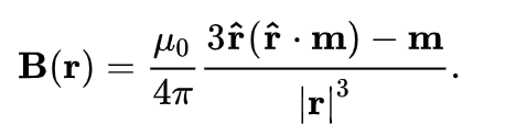

Find B in the z-drection
B = (u/4pi)((3z(z.m)-m)/(|z|^3))
I thought I could replace r^ with z^ and |r|=z since it's only in the z-direction. Is it okay for me to do that?
Also, do I need to consider the magnetic dipole moment, m, only in the z-direction as well? Or can I just keep it as m?
So assuming that I can replace r^ with z^ and keep m as just m. My answer is
Bz(r) = (mu * m) / (2 * pi * (z^3)).
Is this correct? Can I say ^r*^r=1?

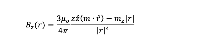

This is what I got.

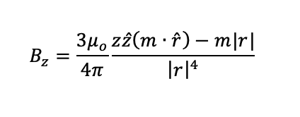

Well there is a slight mistake, the dipole moment ##m## is a constant vector so it will have a z component ##m_z\hat z## put that instead of the second m in the above expression but leave the m inside the dot product unharmed.
I still don't get why only the first ##\hat r## is replaced with ##\hat z## and same for m for the second one.
Because the dot product is a scalar, it depends on the coordinates (x,y,z) (or ##|r|,\theta,\phi)## but its a scalar, it is a quantity that "propagates" as a multiplicative constant to all three components ##B_x,B_y,B_z## of the magnetic field.
Now it is correct to write it more properly with the unit z vector ##\hat z## at the end it will be
$$B_z(r)=\frac{3\mu_0}{4\pi}\frac{z(m\cdot \hat r)-m_z|r|}{|r|^4}\hat z$$

Sometimes it's helpful to rely on the math. To find the (scalar) ##z##-component of ##\vec B##, you calculate
$$B_z(\vec r) = \hat z \cdot \vec B = \hat z \cdot \left[\frac {\mu_0}{4\pi} \frac{3\hat r (\hat r \cdot \vec m)-\vec m}{r^3}\right] = \frac {\mu_0}{4\pi} \frac{3(\hat z \cdot \hat r) (\hat r \cdot \vec m)-\hat z \cdot\vec m}{r^3},$$ evaluating the dot products that you can. There's no need to guess if ##\hat r## is replaced by ##\hat z##, etc. Just follow what the math tells you. (If you want the vector component, ##\vec B_z(\vec r)##, tack on the ##\hat z## that @Delta2 did in post 18.)
By the way, the factor of 3 is in the wrong spot in both posts 17 and 18.
