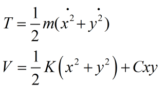

1. A bidimensional oscillator have energies:
With C and K constants
a) show by a transform of coordinates that this oscillator is equivalent to two isotropic harmonic oscillators.
b) then find two independent constants of motion and verify this using:
with "a" the constant.
I tried to do this problem with a transform of kind
So the Lagrangian is
I wrote the Hamiltonian so in this case represent the energy and this will be a constant of motion, but I can't find the second constant in this problem... I don't Know if the transformation that I used is the correct, or if is another transformation to convert the equivalent problem to two isotropic harmonic oscillators.
I hope you can help me
Thanks
Don't you just have to show that L = L1 + L2 where L1 is for one oscillator and L2 is for the second oscillator?
I have to apply some transformation that make the problem convert into a problem of two isotropic harmonic oscillators.
I guess that the Lagrangian is the sum of two terms, just like you say, but I don't know if is right the way that I used.
How is the term isotropic supposed to apply in this problem? You've managed to transform the Lagrangian into two independent one-dimensional oscillators. But isotropic implies more than one dimension to me. Does the problem statement really say isotropic? Or is there some meaning of isotropic I'm not familiar with?
The OP shows a Lagrangian with an xy term that cross couples the x and y dimensions. The OP then transforms the x,y into q1,q2 coordinates in order to eliminate the xy term coupling.
From there the Lagrangian looks like the sum of two independent harmonic oscillators so I'd say the OP has demonstrated the answer.
I'm not versed enough to definitively say this is correct ( I took this course over four decades ago) so hopefully another mentor or science advisor will concur.
Yes, just like you say that was the answer to the problem to separate in two oscillators, the part of isotropic was a mistake because when C=0 the system was isotropic and therefore Lz is a constant of motion.
Summarizing, H=H1+H2 was the answer, so my two constants was E1 and E2, and obviously the condition exposed in the problem (da/dt) is correct for this constants. Now if C=0 appear another constant (Lz).
Thanks you so much for your help.

What you called the Lagrangian in the original post is actually the Hamiltonian. The Lagrangian is L = T-V. You have T+V.
To evaluate the off-diagonal elements of A, start with explicit solutions for x and y:
\begin{align*}
x &= A_x \sin(\omega t + \theta_1) \\
y &= A_y \sin(\omega t + \theta_2),
\end{align*} find the corresponding momenta, and plug everything into the expression for ##A_{12}##. Express the amplitudes in terms of the oscillator energies and K.
