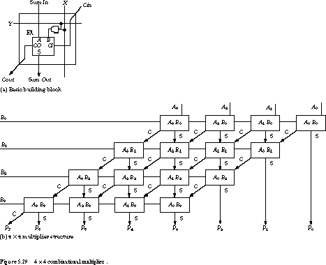

I've been tinkering with Logical Circuit, and have devised a possible multiplier. It appears to function, and operates this way:
. . . . . b1 b0
. . . .x a1 a0
c3 c2 c1 c0
It will obviously have a maximum result of 1001 or 9 at this point.
[URL]http://173.212.220.214/img/Multiplier.Png[/URL]
I also found this schematic, that looks a bit more promising, and seems to be a 4 bit multiplier already, that is expandable.
"[URL
http://www2.elo.utfsm.cl - Figure 5.29[/URL]
So, now I just need to figure out what the "excess three" approach is, and how to employ it.
:D
:D
I went back and looked at it, and now I believe that your original approach (add "3" if more than "4") may be an easier approach.
What they are doing is eliminating the need to do the final computation in decimal when converting from binary to decimal. This eliminates the need for any type of decimal adders. The down-side is the fact that it requires comparators.
All you would need otherwise for conversion is a simple BCD adder. Excess-3 and other types are not necessary because there is no need to subtract when converting.
