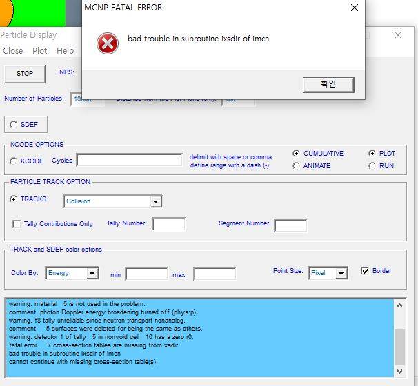

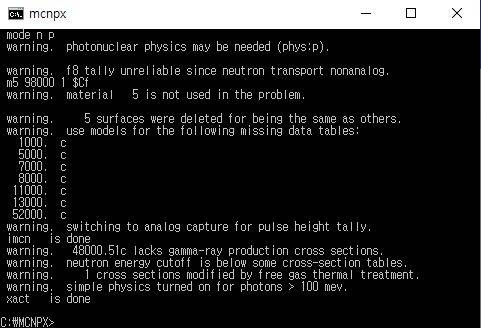

Thanks for your reply.
When I used the code through the mcnpx, the mcnpx didn't work completely and seemed to have errors with some warning phrases. So I implemented it with a visual editor, and the following warning came up.
I guess there was probably a problem setting up phys or imp:n because it's okay to shoot only photons except Neutron. But I don't know exactly where the problem is and how to fix it.
Thank you so much for taking the time to care my question.
First I think you have a library problem.
For a neutron transport, materials must be write ZZAAA not ZZ000. For example 1001 not 1000 ; 8016 not 8000
Some libraries use ZZ000 for natural abundance elements, but that is very patchy. There clearly is a library problem. Some surfaces are the same as other surfaces, so the problem needs attention.
To me the problem file seems to contain a lot of mistakes and probably needs to be fixed line by line.

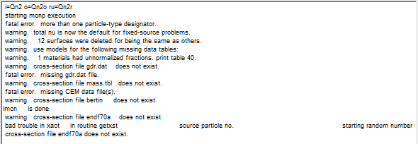

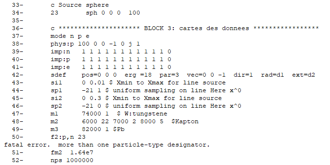

Hi,
I'm trying to calculate the number of photons-neutrons produced when an electron beam hits a target, but when compiling the MCNPX code, I find these fatal errors, and actually I don't understand them and how I can solve them:
fatal error. missing gdr.dat file.
fatal error. missing CEM data file(s).
fatal error. more than one particle-type designator

First you cannot write f2:p,n but :
F2:n 23
F12:p 23
Second you have problem with the libraries
For W write
M1 74182 -.3 74183 -.1 74184 -.3 74186 -.3
For pb :
M3 80206 -.24 80207 -.22 80208 -.52
For kapton :
M2 6000 22 7014 2 8016 5
Mx2:p 6012 j j
For your source I think there is a mistake I would have written something like :
Sdef pos=0 0 0 erg=18 par=3 vec = 0 0 -1 dir=1 rad=d1
@Asmae SAADI ,
mcnpx cannot find your data files. Most probably your DATAPATH variable is not set, or not set correctly. Your xsdir file is presumably present, or you would get a different error. I have mine edited so the first line looks like
Code:
DATAPATH=/media/alex/path/to/MCNP_DATA/
(I am in linux)
