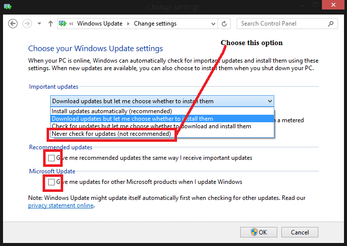

yungman said:
How do you disable windows update in Win 8?
Press Windows Logo + Q. In the Search field that appears - type control panel. Click on the control panel. There you will see Windows Update icon. (In case you miss that, type Windows Update on the top right search field of the control panel.) Then click the Windows Update icon, go to change settings, and from the drop down menu under "Important Updates", select Never check for updates. Also uncheck the two check boxes.
Windows 8 Change settings dialog in Control Panel with the Important updates dropdown open, the option Never check for updates (not recommended) boxed in red, and two unchecked checkboxes marked in red.
Click apply - ok and you are done!

  • Windows 8 Change settings dialog under Windows Update with the Important updates dropdown open and "Never check for updates (not recommended)" highlighted, plus red boxes marking the unchecked recommended and Microsoft Update checkboxes.
