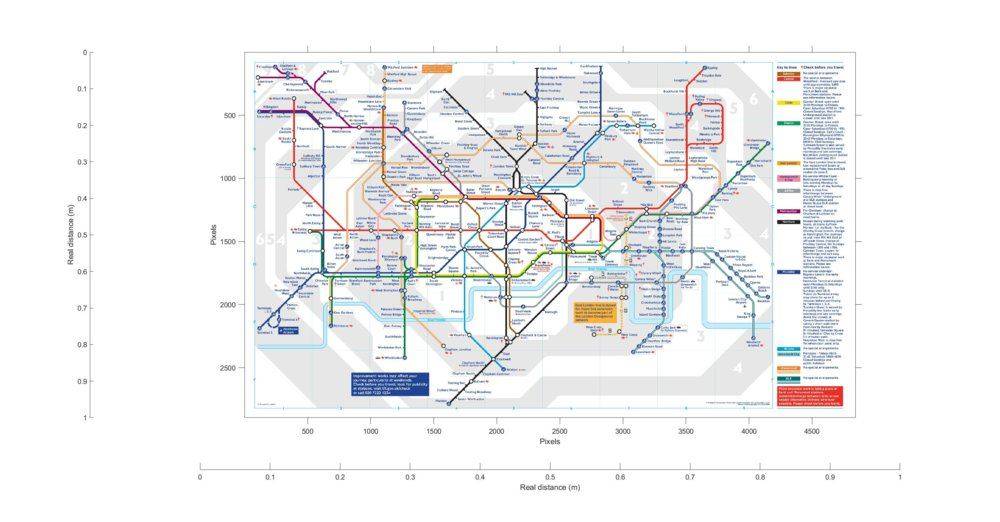

1) The obtained image test2.jpg has bad quality - it became strongly pixelated.
2) The horizontal axis is bigger than the image.

You are creating a figure that include your original image (1000x598) at 70% scale.
Put it in at 100% scale and make the final image bigger than the original. Big enough to include the original image at full scale as well as the graphics you're adding.
Right now, your output image is only 1000x522
Don't save your output image (with all the axes, graphics, labels, titles, etc.) as JPG format. Yes, that will give you a crappy image. Save the image as PNG format, which is lossless compression and will give you exactly what you see. Be sure to maximize your screen first so your output image is as big as possible (most resolution).

But it didn't work - the resolution of the obtained image is very bad, and the horizontal axis is still bigger than the image size in corresponding direction.

Try export_fig by Yair Altman, on the File Exchange, or maybe try the truesize() function.
Thanks a lot! I will try these functions.
