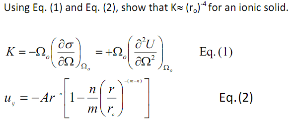

Using the equations, show the bulk modulus is about r^-4.
Tried to plug Uij but it is not same as U. To be honest, I don't know where to start.
What values were you given for ##m## and ##n##? If you weren't given values, what pair potential have you discussed in class?
What's the relationship between ##r## and ##\Omega##?
