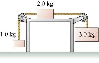

Problem 1
The coefficient of kinetic friction between the 2.0 kg block in figure and the table is 0.260.
What is the acceleration of the 2.0 kg block?
MkN=ff
T=m*a
I went through and calculated the force of friction which gave me 5.096N. However, I'm not entirely sure where to go from there. I know that you need the sum of the forces acting on the 2kg mass in the x direction and divide that by the total mass of the system.

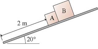

Problem 3
1. Homework Statement
Two packages at UPS start sliding down the ramp shown in the figure. Package A has a mass of 4.00 and a coefficient of kinetic friction of 0.210. Package B has a mass of 9.00 and a coefficient of kinetic friction of 0.140.
How long does it take package A to reach the bottom?
F=m*a
I'm not even really sure how to attempt this problem. I know you can draw a free body diagram and figure out the equal and opposite forces, but where to go from there?

Problem 1
MkN=ff
T=m*a
This does not look right to me. The net force is equal to ma; but here there are two ropes and therefore two tensions that are acting in opposite direction, as well as the force of friction. What would the net force in the x direction be for the 2kg object?
fronomo said:
I'm just going to post a few questions in this post. After missing a day of class I am having difficulty with the homework for the day.
Problem 1
MkN=ff
T=m*a
You seem to have everything you need to solve this. When you sum the forces, just remember the directions each is acting - it should be fairly obvious for the tensile forces and the frictional force will work opposite the direction of motion.
