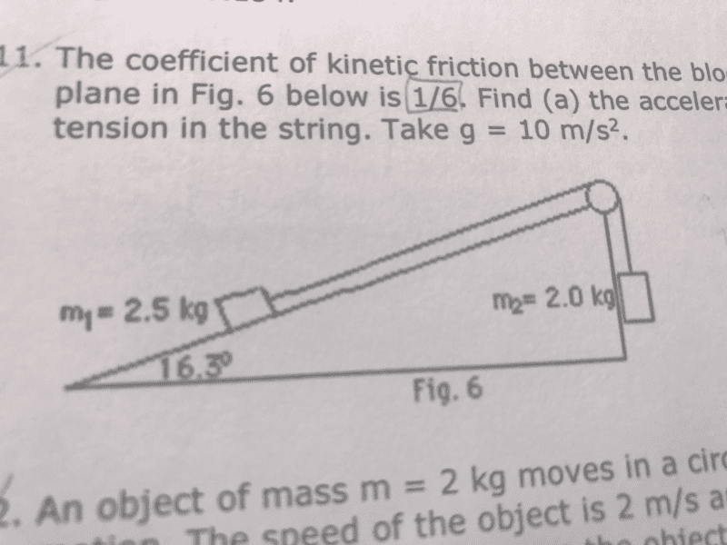

The coefficient of kinetic friction between the block of mass m1 = 2.5 kg and the plane in Fig. 6 below is 1/6. Find (a) the acceleration of the block and (b) the tension in the string. Take g = 10 m/s2.
Physics diagram, Fig. 6: a block of m1 = 2.5 kg on a 16.3° incline, connected by a string over a pulley at the top to a hanging block of m2 = 2.0 kg.
Fnet=ma
please i don't know what is the mistake here. the answer should be: a=2m/s^2 .
by the way i am assuming that the orange block is accelerating to the left down across the incline and so the green block up

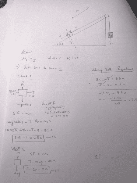

this is my attempt :

i got a=-3.7 m/s^2
I would change the sign of the tension force and the weight (mgsin(theta)) of block 1. Usually "up" the ramp is defined as positive.
do you mean that the system will move up right? like hanging block would go down
Compare the force of gravity on block 2 to that on block 1 when block 1 is on the ramp. Block 2 should go down.
Thanks i got it just few seconds before you reply :smile:
