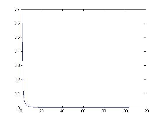

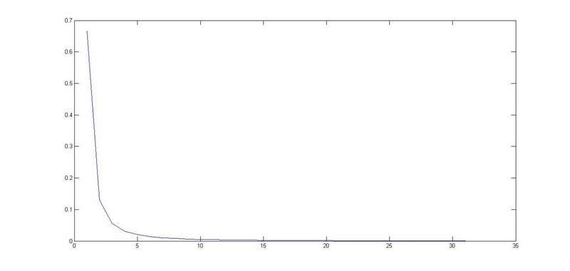

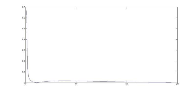

Print out value of "error" in the first terations (say the first 100). Is it converging monotonically, or oscillating, or jumping about "randomly"?
the error is exponentially decreasing and some times it is raising up at certain values of n,like you can see in the images down below at n = 25.

Very strange.
I don't understand the first value of "error". On the first iteration everything in the calculation of Tsol should be 0, apart from one value in the B array which is 300. dx = 0.25. So the only non-zero value in tsol should be
300 * (0.25)^2 / 4 = about 4.7. But on your plots it is about 0.67, not 4.7.
Maybe I misunderstood what your code does, or maybe you are not running the same code that you posted here.
Incidentally, why is the abs(...) function in the calculation of tsol?
