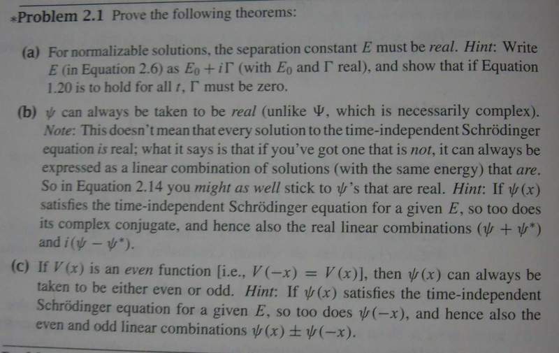

Printed textbook page showing Problem 2.1 with parts (a), (b) and (c) asking to prove theorems about separation constants, real wavefunctions, and even or odd solutions of the time-independent Schrödinger equation.
I don't know how to prove b.)
