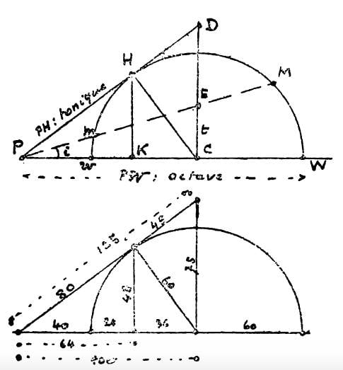

Hello, everybody:
I am a philologist who is fond of mathematics, but who unfortunately has just an elementary high school knowledge of them. I am translating La leçon de Platon, by Dom Néroman (La Bégude de Mazenc, Arma Artis, 2002), which deals with music theory and mathematics in the works of Plato. The problem which brings me here is not about translation, but about mathematics. It is a long and complex one, so please take your time for examining it. Just in case, I am attaching a PDF document with my problem, to avoid any confusion with the reading of the mathematical expressions below.
On p. 93 of that book, there is this figure:
In the reproduction of this image in my translation, I have not only translated the indications in French, but also substituted 0 for C, and L for D, to avoid any confusion with C and D as names of musical notes in English. For dealing with the problem that I am going to expose here, I have also added some lines and letters in red ink:
On p. 91-2, the author gives a series of measurements of segments of that figure, assuming that PH = 1; PW = 2, and PW x Pw = 2 (2 – wW) = 1. Then, Pw = PW – wW = 2 – wW; PW x Pw = 2 (2 – wW) = 1; 4 – 2wW = 1; 4 – 1 = 2wW; 3 = 2wW; wW = 3/2. So, 0H = (wW)/2 = (3/2)/2 = 3/4, and P0 = √(1+9/16)=5/4.

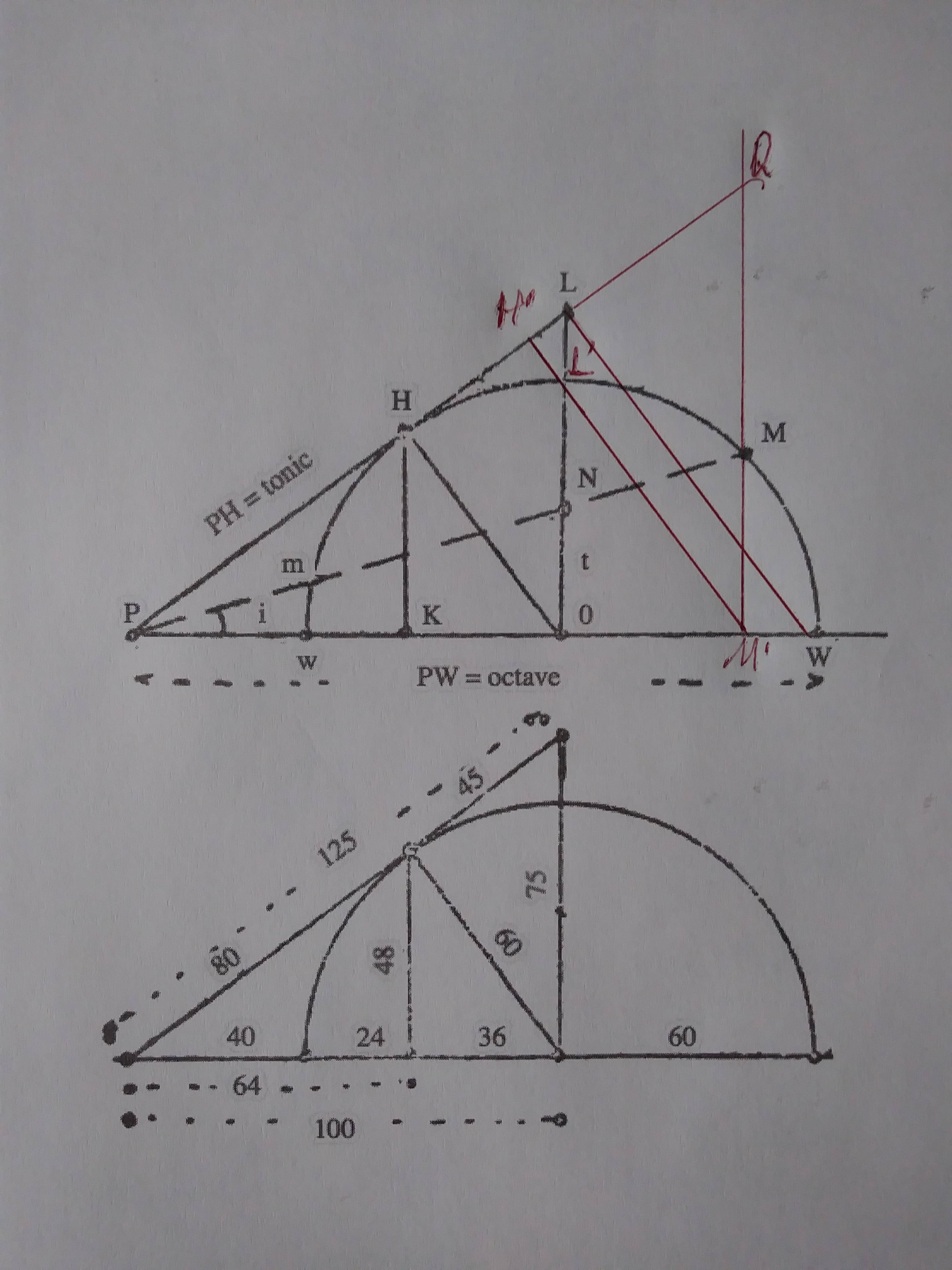

Then, on p. 93, the author says that the ratio \[ PM/PH \] can be expressed by the formula \[ 5±√(9-16(tani )^2 )/(4√(1+(tani )^2 )) \], but he does not demonstrate it. This is my problem. I would like to demonstrate that myself, but I have not been able to do that so far.
I have thought that I must express PM and PH as functions of tan i:
a) I think it is not too complicated to express PM as a function of tan i. Let us remember how I completed the figure as a helping device:
For expressing PM as a function of tan i, taking into account that \[ tani=MM'/PM' \], I have done this:
\[ tani=MM'/PM'↔MM^'=PM^'∙tani; 〖PM〗^2=(PM^'∙tani )^2+〖PM^'〗^2=〖PM^'〗^2 [1+(tani )^2 ]↔PM=√(〖PM^'〗^2 [1+(tani )^2 ] )=PM'√([1+(tani )^2 ] ) \]
b) For expressing PH as a function of tan i, I have noticed that, if we draw a perpendicular to PL, passing by the point in which 0L cuts the semi-circumference of our figure, and we lengthen it until it cuts the segment wW, we obtain the point M’ of the segments PM’ and MM’ with which we operated in the previous section. This may help us, as we shall see later.
On the other hand, there are two triangles, PH’M’ and PLW, which are similar to PH0.
We know the dimensions of PH0: PH = 1; 0H = 3/4, and P0 = 5/4.
On the other hand, 0H = 0w = 0W, so that PW = P0 + 0w = P0 + 0H = (5/4) + (3/4) = 8/4 = 2. This may help to find LW, since \[ P0/PW=H0/LW↔(5/4)/2=(3/4)/LW↔(LW∙5/4)/2=3/4↔LW∙5/4=2∙3/4=6/4↔LW=(6/4)/(5/4)=24/20=6/5 \]
Now we must find 0L. The triangles PHK and PL0 being similar,
\[ PK/P0=HK/0L↔(4/5)/(5/4)=(3/5)/0L↔16/25=(3/5)/0L↔16/25∙0L=3/5↔0L=(3/5)/(16/25)=75/80=15/16 \]
Now, knowing that 0L = 15/16, that 0L’ = 0H = 0W = 3/4, and that the triangles W0L and M’0L’ are similar, we may determine 0M’:

But I cannot see how to simplify that monstrous equation to obtain \[ PM/PH=5±√(9-16(tani )^2 )/(4√(1+(tani )^2 )) \]
Thank you very much in advance for whatever help in detecting any wrong assumptions or calculations, and in the demonstration of that formula.
All best!
