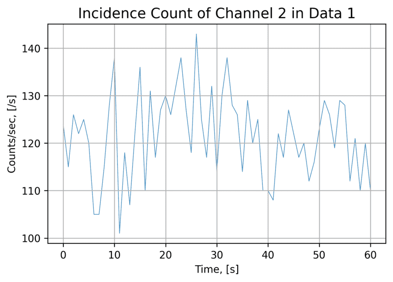

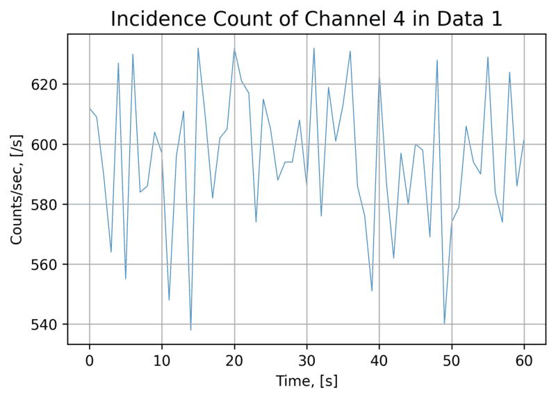

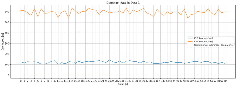

I generated some graphs from jupyter notebook, still it does not make sense to me.
I have also found the respective maximum values
Time (s) 60
Ch2 (counts/sec) 143
Ch4 (counts/sec) 632
Coincidence (pairs/sec) (delay:6ns) 0
dtype: int64
and also the respective mean values
Time (s) 30.000000
Ch2 (counts/sec) 121.508197
Ch4 (counts/sec) 595.508197
Coincidence (pairs/sec) (delay:6ns) 0.000000
dtype: float64
I hope someone could give me some insights of how to calculate the dark count, thank you so much for your time!

  • Line graph titled Incidence Count of Channel 2 in Data 1, plotting Counts/sec [/s] (about 101 to 143) against Time [s] (0 to 60), fluctuating around 120 counts/sec.

  • Line graph titled Incidence Count of Channel 4 in Data 1, plotting Counts/sec [/s] against Time [s] from 0 to 60 s; counts fluctuate roughly between 540 and 630 per second with no clear trend.

Were the Ch2 measurements taken with no light source?
Yes, there is no light source in it .
Since there is no light source producing the Ch2 readings, why do you think the Ch2 counts are non-zero? What is producing the Ch2 counts?
You haven't provided any description of the setup. We are left to guess! What are the inputs to Ch2 and Ch4? Are the efficiencies of Ch2 and Ch4 identical? What coincidences are being detected? Why do the results show zero coincidences? Is the sole purpose to measure the dark count rate or is there some other objective? Etc.
Then are the Ch2 counts/s not already the dark current/s? I'm not sure what your setup is, what sensors you're using, etc. For a CCD or CMOS camera sensor, I would take a 'dark frame', subtract the built-in bias via a bias frame, and then divide by the exposure time to get dark current per second for each pixel. I'm not quite sure how this works for a DC current from whatever your sensor is.

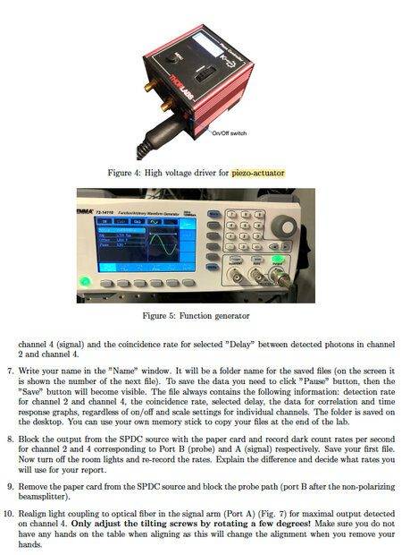

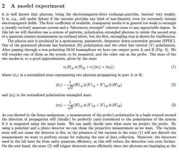

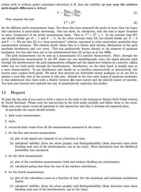

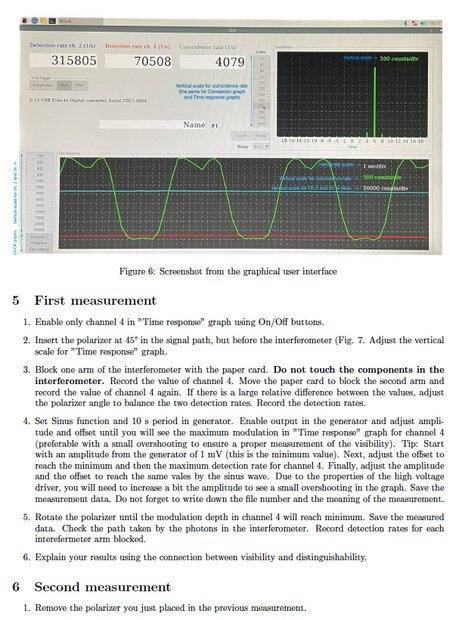

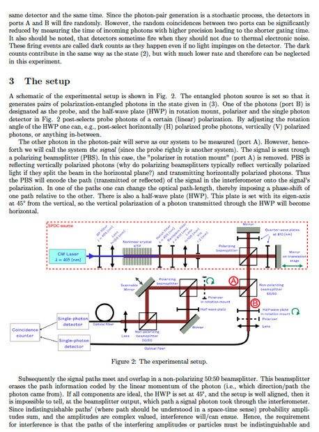

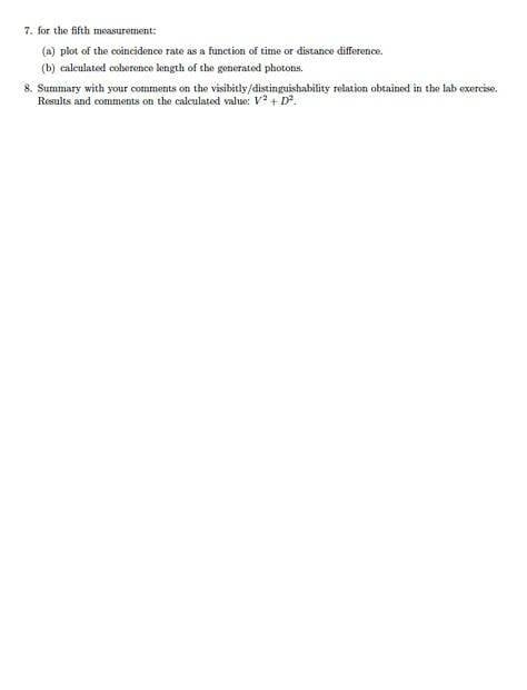

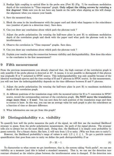

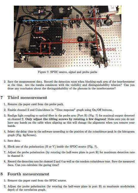

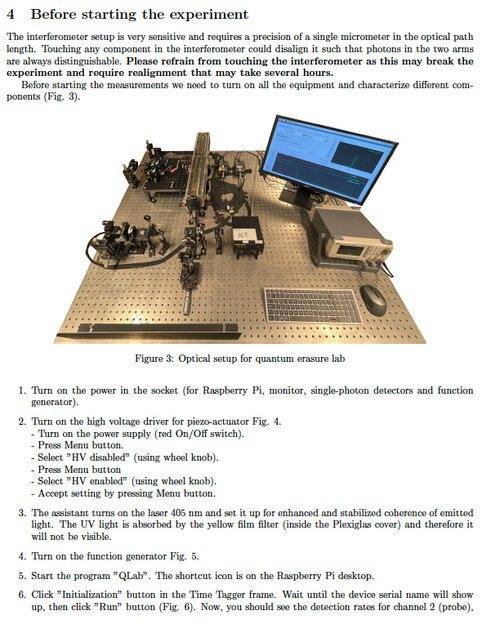

Please kindly find all the images about the experiment. Can I ask questions other than dark count? I feel this experiment is so difficult for me complete.

  • Typeset page of physics text with numbered equations V = (R_max - R_min)/(R_max + R_min) and V^2 + D^2 <= 1, followed by a Report section listing lab measurement requirements.

  • Screenshot of a graphical user interface showing detection rate counters for channels 2, 4 and coincidence, plus a time response graph with a green sine-like waveform and a vertical scale of 500 counts/div.

  • Photo of lab equipment: a red and black high voltage driver for a piezo actuator with an on/off switch labelled, above a Tektronix-style function generator with a small screen showing a sine waveform and a keypad.

  • Printed page of text on a model experiment with photons, including the state equations c0|0>A⊗|0>B + c1(|ψ1> + |ψ2>) and the normalized states |ψ1> and |ψ2> written with H and V polarization labels.

The images of the text you posted seem to be in a random order without page numbers. I’ve looked through them and they seem to include Sections 2 -10 (but in random order) of some document - but there is no Section 1. Maybe Section 1 pulls the whole thing together.
This seems to be some sort of quantum entanglement/erasure/delayed-choice experiment, or similar. But I can’t see any clear statement of the overall objective/purpose.
There are a number of very specific steps to follow – your best bet might be to try following them and see what happens. Then the overall picture might become clearer.
I’m not knowledgeable in this area so it’s very difficult (for me, anyway) to offer any specific advice. Sorry I can’t help more.

Okay, according to section 3, the 'probe' is simply one set of photons exiting the 2nd beamsplitter in port B, while the 'system' is the other set of photons exiting the 2nd beamsplitter in port A. So each photon pair is split into a probe photon and a system photon. Each photon beam is detected by its own separate detector.
I have zero experience with this, but I would think you would simply measure the output from each detector without the photon source turned on to get the dark current. Although if you already did this above then I don't know why Ch2 and Ch4 have wildly different counts unless they are different types or brands of detectors.
