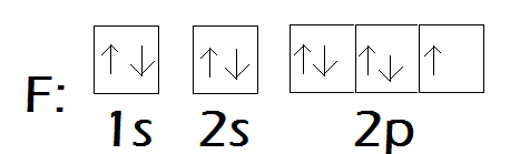

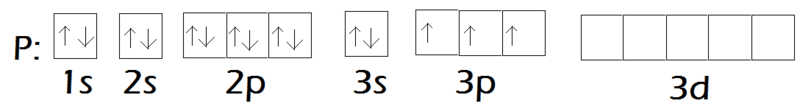

Phosphorus: sp3 hybridized
Fluorine (each one of three): sp3 hybridized
Back bonding can occur between only PURE orbitals ie those which are unhyridized.
Let's look at e- config. of both of them to be a little clear of what I'm asking:
P:
F:
Since fluorine is sp3 hybridized, the orbitals ie either of px, py or pz (2 of which are filled and are lone pairs on F of the 3 total lone pairs) can't participate in back bonding with the unhiybridized d orbital of Phosphorus.
My question is, then how does it show back bonding? I know it does, but how?
I don't know. Is it?

In general , every compound in which central atom has vacant orbitals and adjacent atoms(or even molecules) have lone pair of electrons back bonding occurs.
Here P has vacant 3d orbitals even when it is sp3 hybridized to form normal covalent bonds with p orbitals of F atoms( note that the hybridization occurs only to the orbitals of the central atom ). Also there are 3 lone-pairs available for each F atom. This satisfies the general condition and thus back bonding is likely to exist in PF3 molecule.
Hope you are clear.

Hybridization is not a property of an atom but a way to explain certain types of bonding, and geometries more easily. In fluorine, the energetic difference between s and p orbitals is so high, that hybridization makes no sense and is also not necessary as a linear bond geometry can be explained without hybridization.
What is even more problematic is that bonding and backbonding involving d-orbitals in main group compounds has since long been disproven. Nevertheless chemistry teachers seem still to be widely ignorant about this fact. See for example, https://onlinelibrary.wiley.com/doi/abs/10.1002/anie.198402721
