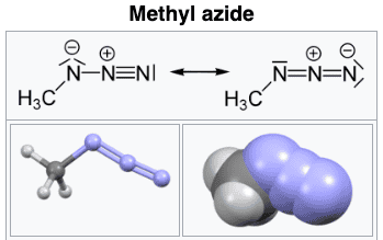

After looking on Wikipedia, it seems the structure is
Two resonance structures of methyl azide, H3C-N-N-N, drawn with Lewis-style bonds and formal charges, shown with a double-headed arrow between them, plus ball-and-stick and space-filling 3D models of the molecule.
I am not sure about the reasoning that leads one to the above (resonant?) structures. Let's call the leftmost structure A and the rightmost structure B.

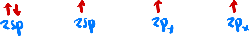

A nitrogen alone has the valence electron configuration
Handwritten orbital diagram in blue and red: three empty 2p boxes labelled 2px, 2py, 2pz each with one up arrow, above a 2s box containing an up arrow and a down arrow paired.
Now, in both the structures, there is are no unpaired electrons or any lone pairs on the middle nitrogen because, for some reason that I am unaware of, one of the electrons on the middle nitrogen goes over to another nitrogen.

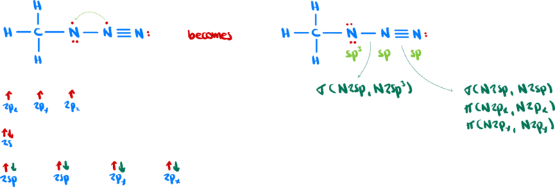

In structure A, we have
Diagram of a methyl azide resonance: H3C-N(lone pair)-N=N-N with a curved arrow moving electron density, becoming H3C-N(sp2)-N(sp)=N(sp) with orbital labels and sigma and pi bonds, plus an orbital filling diagram for nitrogen 2s and 2p.

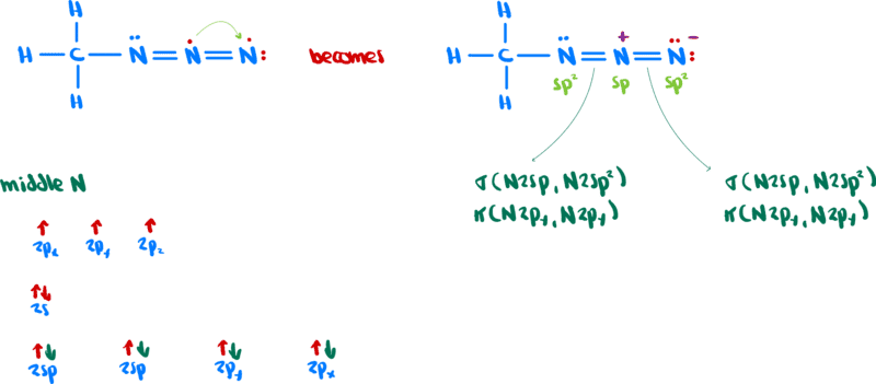

Similarly, in structure B we have
Handwritten Lewis structures and orbital diagrams of CH3N3: a resonance pair of structures, labelled with the middle nitrogen's 2s and 2p orbital occupancies and sp, sp2 hybrid labels with sigma and pi bond annotations.
The middle nitrogen has the same hybridization in both structures. The difference is that in one case two ##\pi## bonds are formed with another nitrogen (for a triple bond) and in the other case there is one #\pi# bond with each nitrogen (for two double bonds).
My question, first of all, is if this analysis is correct.
